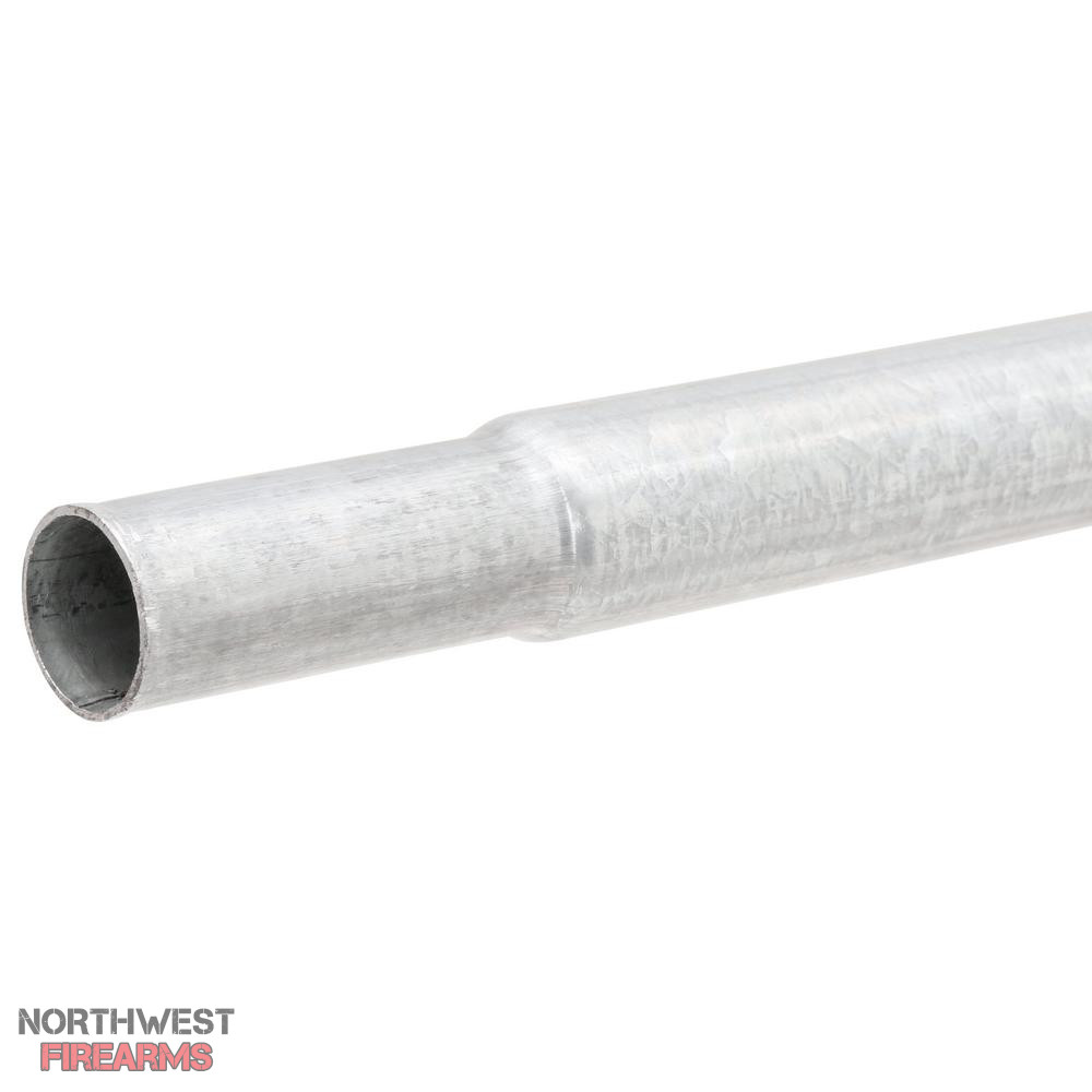

Looking at antenna masts, I am thinking for now I will cheap out with two or three chain link top rails, each 10' long, fitted into each other:
These are 17 gauge galvanized, which is pretty similar to what Rohn sells in 5' sections (16 gauge).
Home depot has these for $14 each, two would get me above the roof by about 5-7'. More than that - another 10' section - and I might want to put up a guy wire as the jointed section itself is maybe not that good free standing?

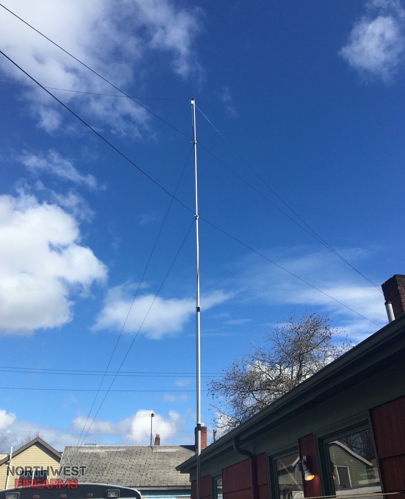

I just happen to have 2 complete 38' hd collapsible masts I need to let go of. If you need.
With guy line plates. Never used.
Here's one in place.

These pole sections will work (rub/ vibrate) over time with the wind so you may want to epoxy the connection points or drill a bolt through them so they stay exactly in the orientation you place them for your antenna bearing. You'll also want to run a copper wire for ground from the antenna and stake the ground wire with a short copper bar. The actual base for this probably also needs a small cement pad or some reinforcement mounting plates into the ground.

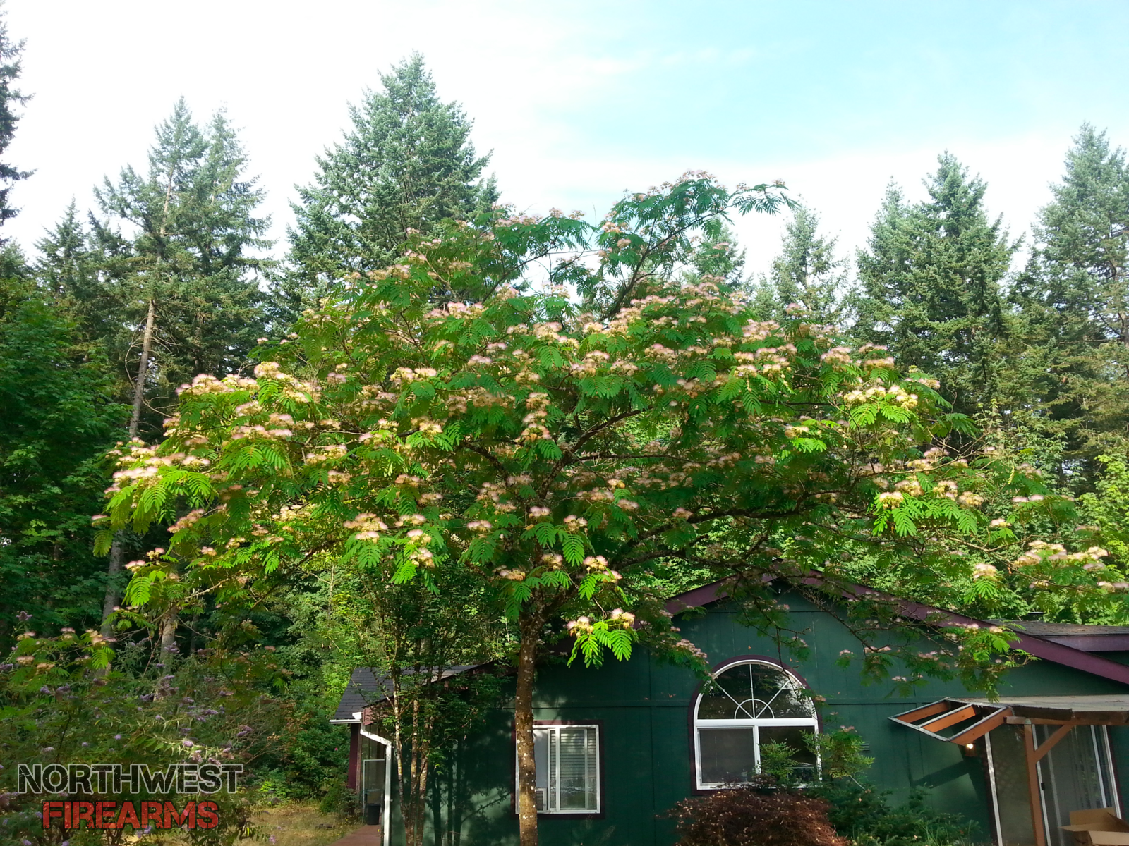

I forgot to mention, I am at about 900' on the north side of the Chehalem ridge which is about 1300' high. I have trees all around me:
So not optimum.
I just want to get a bit of elevation and outside the house - right now I have the antennas setup inside my office. It would be nice if I could hit the repeater on the top of the mountain as it is only a couple miles away and would give me good access around the valley as it is the highest spot inside the valley and has visibility north and south. But I think I am blocked by the ridge and some other terrain. I can see the Portland west hills repeater, but it is 30 miles away.
I use fence top rail. Put in a ground rod, add a brass or copper wire clamp, put the mast on top and secure to peak, and add a stand-off about half way up if needed.
This set up provides a strong ground, no need to run extra wires, but the clamp provides a place to run a wire in case you need to ground other items.
