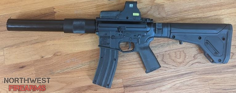

An SBR in HERA CQR stock with a dedicated CMG .22 set up with suppressor? Plus I have 3 uppers with identical stocks, rails and foregrips and setup. My daughters LOVE it. It is actually a ton of fun and quiet. the 4.5 inch barrel under the handguard makes sure every 22lr you throw at it is a sub. And the sig suppressor just peeks out past the end.
