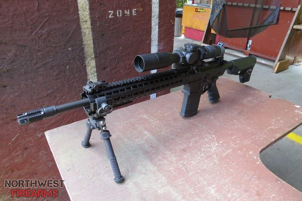

Here is the tool and the play field.

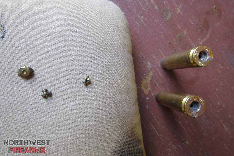

I had a lot of fun but I was experiencing more failures today than the last time I shot it with Jukk0o. I had no failures last time. Today I was getting my bolt jammed tighter than bubblegum because it was destroying or extricating the primers altogether. The loose primer shards were getting stuck in the lug area and jamming my bolt face to where it took some good effort to free the BCG and clear the jam. See below.
That's a great looking gun.

Just from those pictures of your brass, I would guess you have some real pressure issues! With ejector swipes like that and popped primers along with stuck cases. It looks like something serious is goin on...
