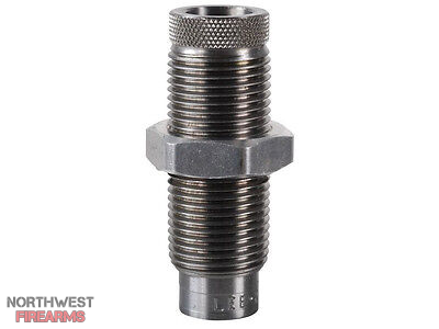

If you're crimping with the roll crimp in the seating die, don't. Use a Lee factory roll crimp die and do it in a separate step.

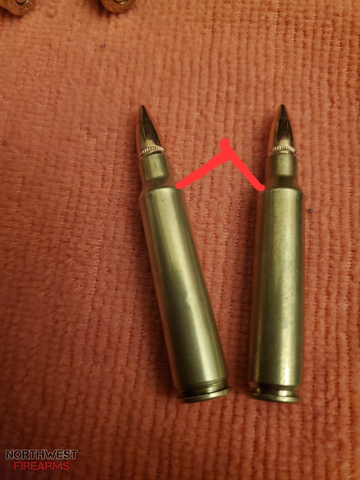

Congrats guys we did it! I think this is a successful first batch.
I used Fiocchi SRP, 24gr old Benchmark powder, and misc 55gr fmjbt.
I did notice after I got started that there are different bullets in the lot of projectiles I got.
It's a bit annoying that the cannelures are different distances, but now I know I've gotta separate them. I did weigh about half as I went through and everything checked out at 55rg, but I feel like I should go through and check all of them. Either way, the 50 I've gotten so far all measure up, pass the plunk test and hopefully fire.

Don't worry too much about the canntilure, I just loaded some Hornady 117grRN's in my 25-06 to the COAL right out of the Hornady loading manual in brand new PPU brass and the canntilure is out of the case mouth by at least a 16th of an inch. In this case I think the canntilure is there to help prevent case/jacket separation rather than as a crimp guide. By seating to the factory OAL and not crimping as compared to my first test loads that were crimped in the groove my group size went from over a 2" group for the first test to a 3/4" group for the second. Also don't expect your first loading to be anything more than a repeatable benchmark that you can compare to. If the next load is better than the first then you can set a new benchmark and if worse then you can go back to the first. I've been making ammo a long time and this is how I do it still with a new rifle.
