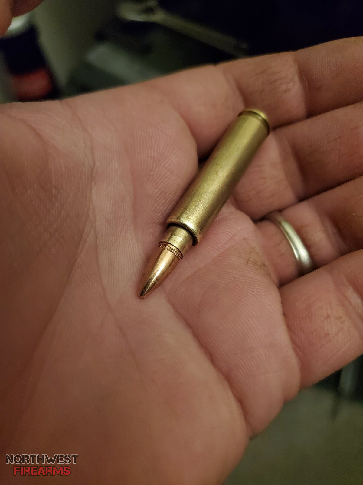

I slowly ran one in the sizing die without the decapping stem to see if I could get it to take shape and I think I made a +p ... 😆 yeah, I'm gonna don't do that again...

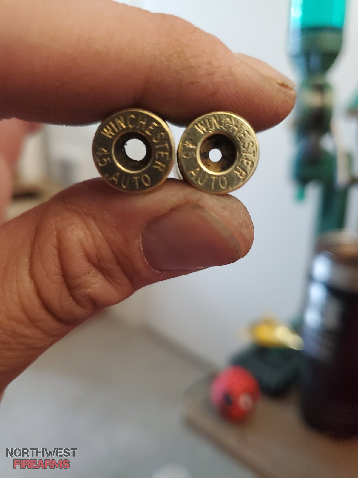

I'm cleaning some fired .45 brass and came across this one (left)
What causes that and is it safe to load?
Looks like someone wanted a bigger hole, should be ok but I'd scrap it myself, I don't like modified flash holes.
