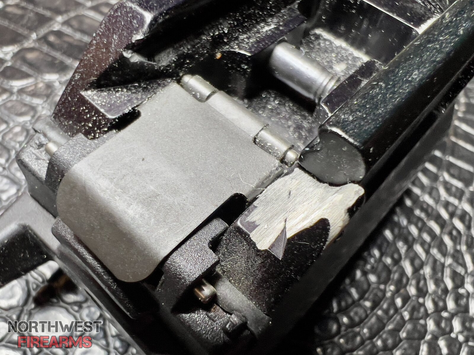

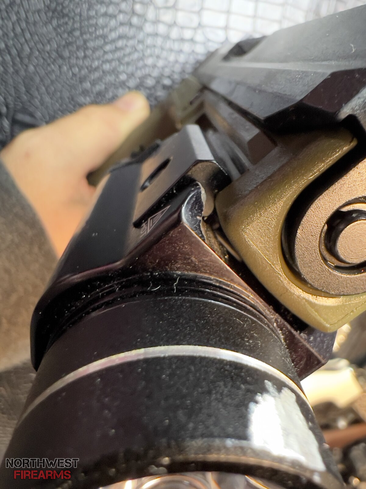

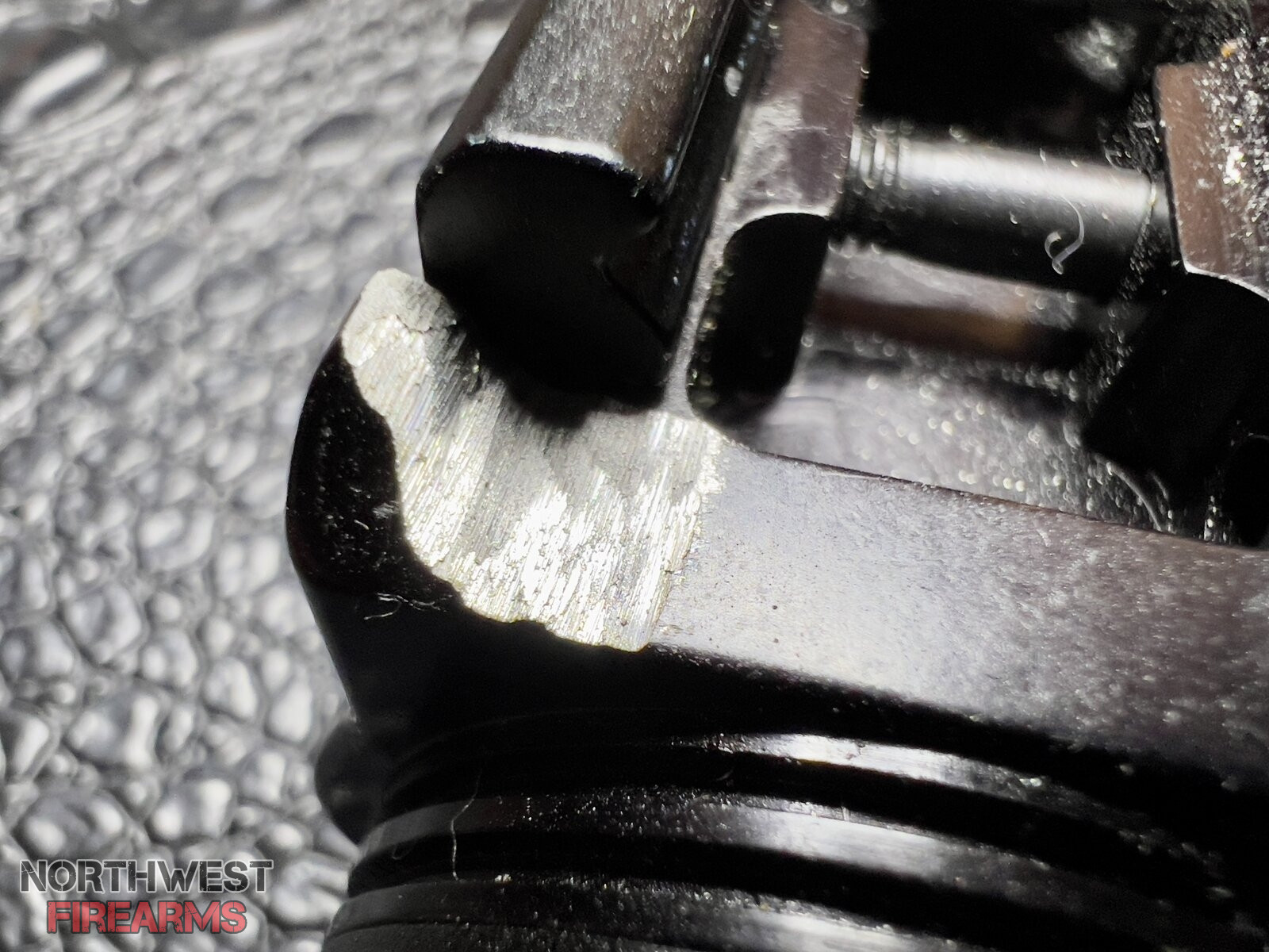

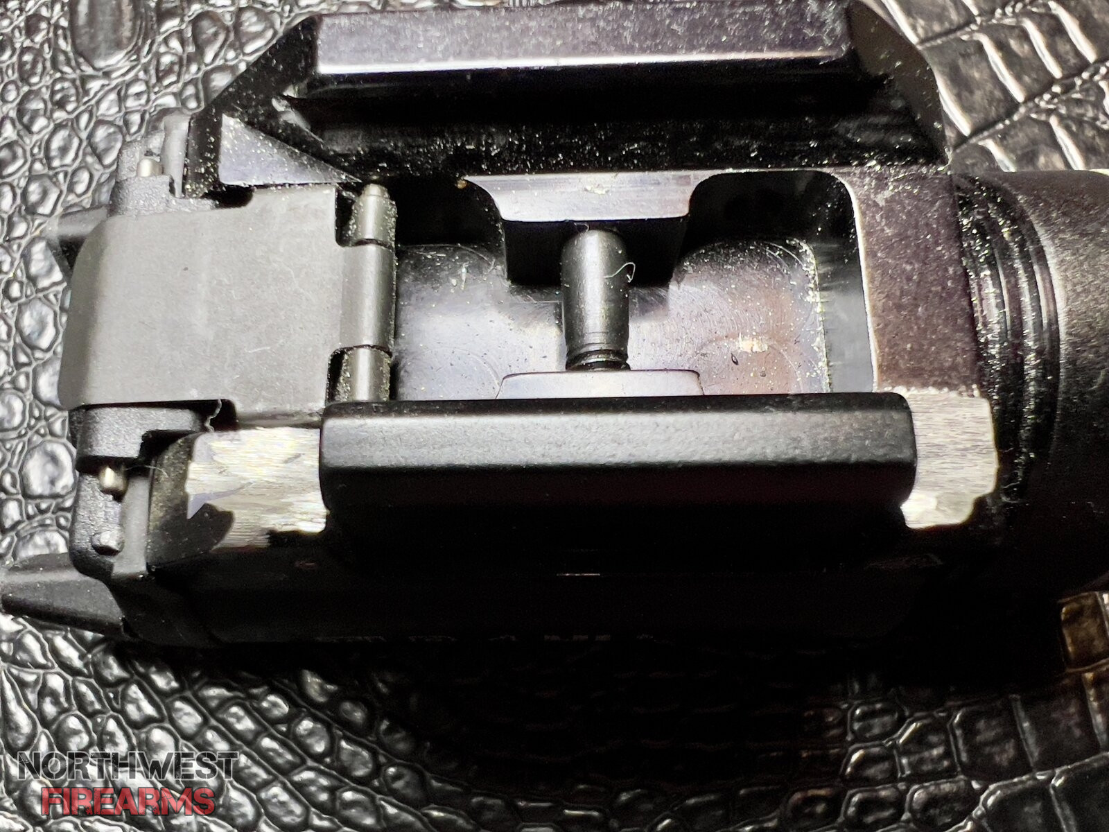

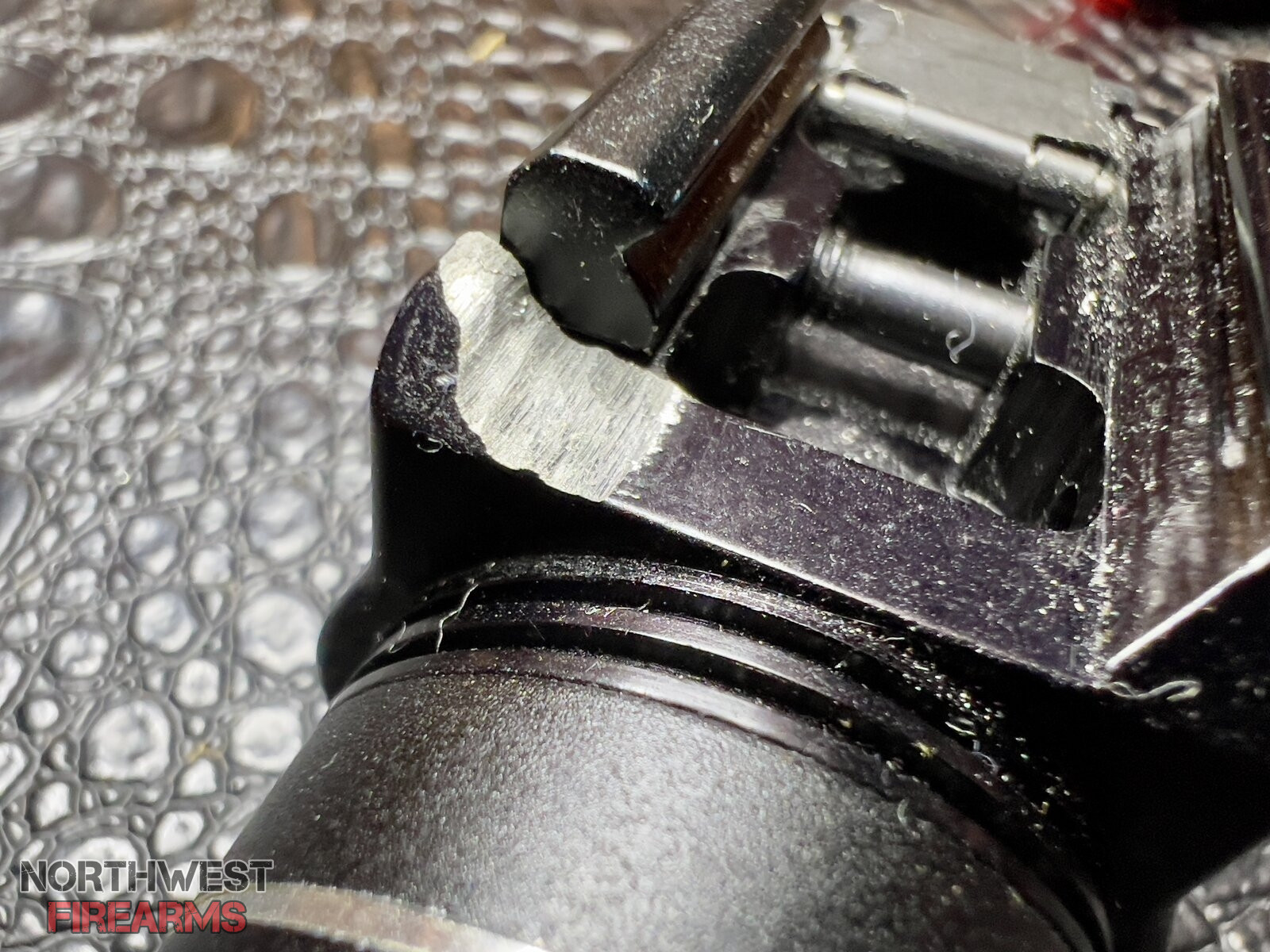

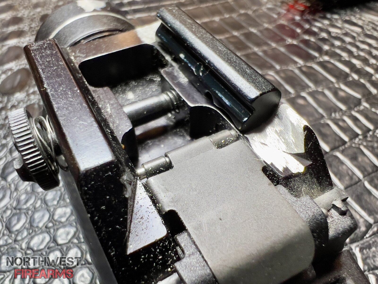

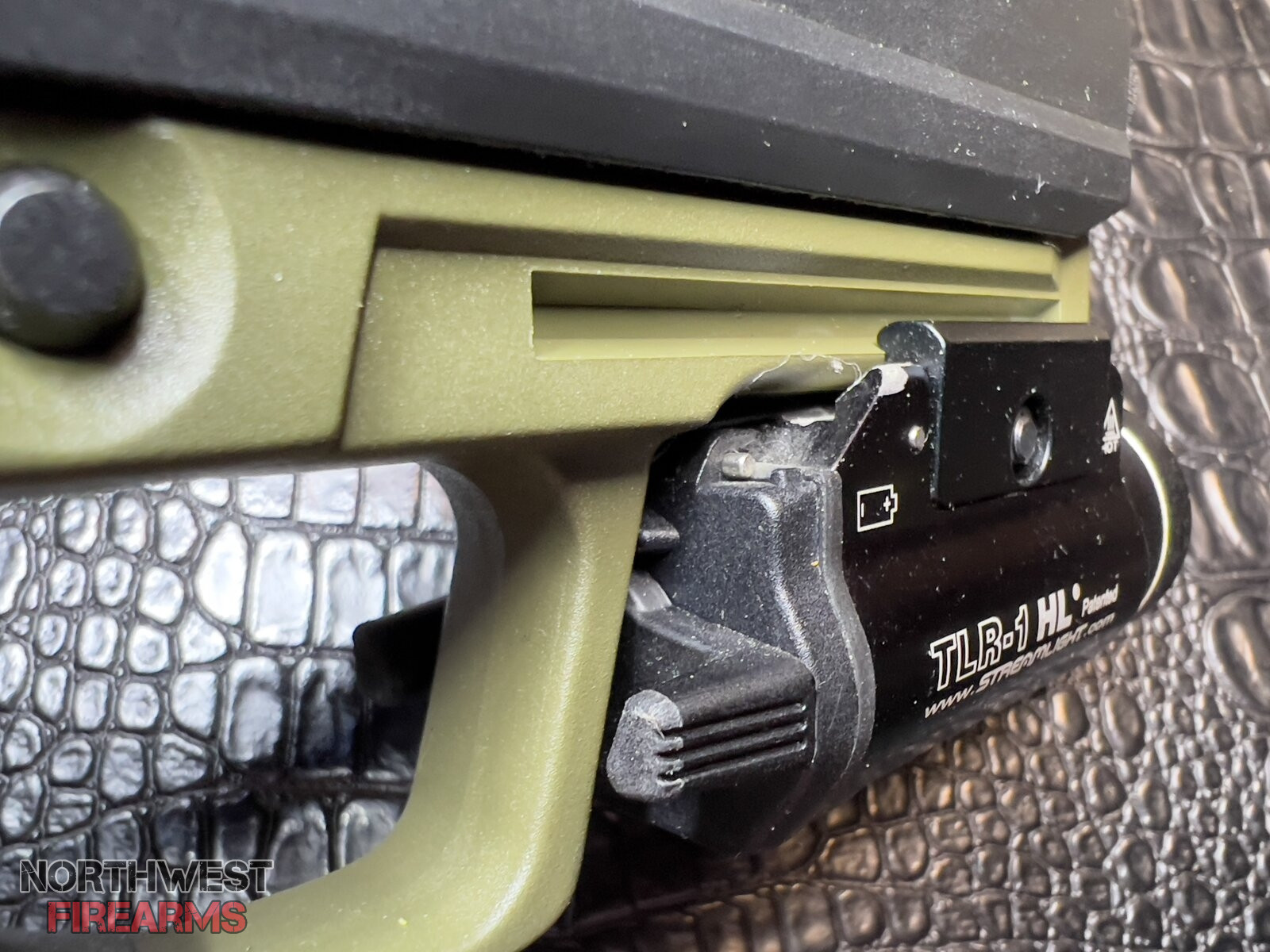

The USP 9 Tactical however- that one is a special secret. I had the Streamlight TLR1 for many years, and was playing with it, trying to see if I could get it to mount to the USP proprietary rail. It looked so close, but not quite. Well i said screw it, and started carefully dremmeling metal off on the underside. Just a couple of areas, and BAM it fits the USP rail PERFECTLY!! I did a write up over on HKPRO forum about it, but lmk if you want to see pics of what i did to modify it. Not only does it work perfectly, but it puts it right in the right place to reach with your thumbs. They make an adapter similar to the Lobos for the USP as well, but it places the light too low IMO and too far forward. This modification costs nothing, and also I like that the TLR-1 has that "retro vibe" that fits the USP well!!
