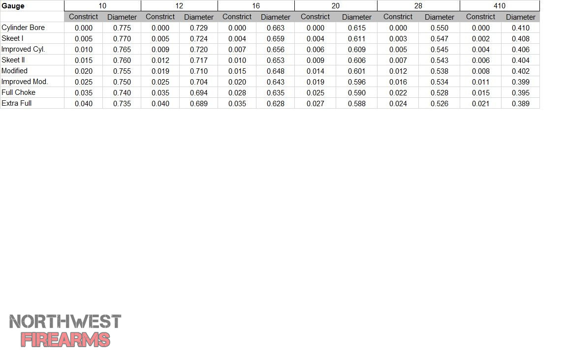

Measuring should tell what you need to know, if you have the ability, if not, and you expect to have continued interest in the gun sports, may I suggest you acquire an always ready, quality analog (dial) caliper -graduated to .001. Down the road you won't be sorry as this won't be the last time such knowledge could bring piece of mind.
Measure the muzzle with calipers and use this table to determine choke.
