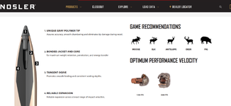

If your asking about terminal performance, again monos do not have any different range than any other bullet, terminal performance depends on the bullet design and its impact velocity regardless of construction. The Ron Spomer video Titsontiz shared above is a great video on that subject worth watching. Regardless of bullet, generally the longer the range the softer the bullet needs to be to expand properly because it will have a lower impact velocity. Most bullet manufacturers list their minimum impact velocity (see screenshot below). (Note: I refer to that as the bullets "terminal velocity" but I dont think there is a standard name for that, anyways...) If you select a bullet, run some muzzle velocity estimates you expect to achieve in a ballistic calculator and it will estimate your bullets impact velocity at the ranges your interested in, then you will know -that- bullets "range". But then dont forget to consider its stability in your rifles twist rate when selecting any bullet, will save you a lot of frustration in group sizes at longer ranges. Also, there is one thing worth noting here comparing monos to cup and cores, as long as you stay at or above the monos "terminal velocity" it will open the same where lead core bullets open differently at different velocities. Most monos also retain virtually all their weight even when they mushroom, some monos like Hammer bullets are designed to fracture the mushroom petals off creating a larger wound channel as low as 1800fps impact velocity, all Hammers are rated to fully open as low as 1800fps. To me, those are advantages worth considering and none of these mono options are limited to longer ranges. For example, both my 280ai with a 140gn Hammer and my 25-06ai with a 127gn Hammer are both still over 2100fps at 600yds.

Example of the different levels of expansion and impact velocities with a traditional lead core bullet, Nosler Accubonds long range: it will still open at long range impacts but not the same at closer ranges, it will kill but "might" see a delayed response in the animal compared to closer range shots with that bullet.
