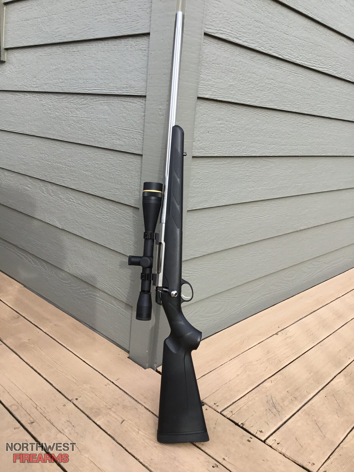

If you want a bolt gun find a stainless Tikka 1-8" twist. If you don't mind heavy get a Varmint instead of a T3/T3x. 24" heavy barrel, big heavy stock, absorbs recoil to the point that I see the bullet hit.
The Superlite was a delight to carry but it was so light I lost the sight picture to recoil. She went down the road.

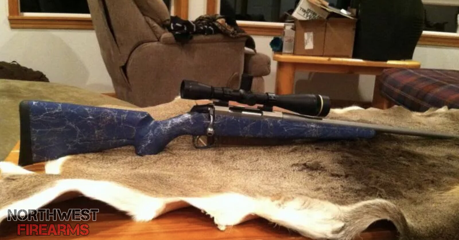

I'll never sell Blue Lightning. 1-10" twist, shoots 50 gr NBT Varmint like you wouldn't believe. The most accurate rifle I own.
But I shoot Varmint Cong the most. 1-8" stainless T3 Varmint. 75 ELDM. Scary.
