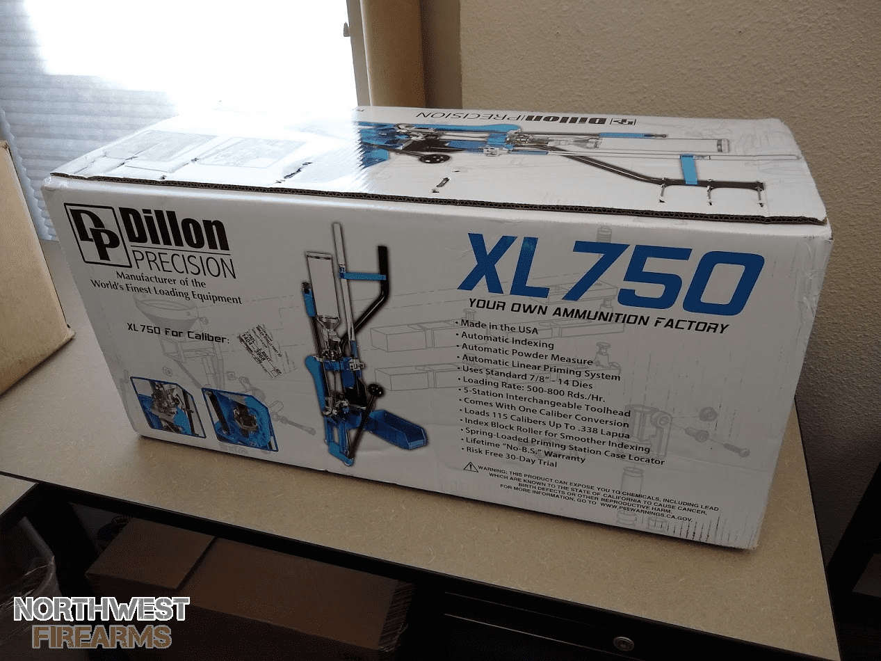

Well, at long last I have confirmation that my Dillon 750 is on the way! I ordered in a few accessories for it today, but I'm still holding off on the Inline Fabrication riser, roller handle, and case feeder until I have a chance to unbox it and get some measurements. I know it'll delay my start to actually reloadiing, but I'd rather get all the ducks in a row before I go and buy something that's not going to work out for me.
Thanks again for all the suggestions!
Got it!
Yaaa for you!
