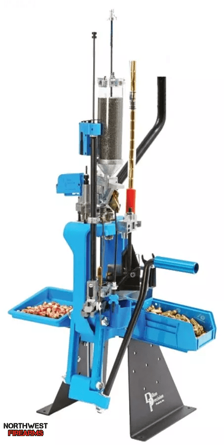

Fast-forward to two days ago when I was perusing the Scheels website. I must have been in the right place at exactly the right time because I managed to score a new Dillon 750xl. Since I've already gotten the order confirmation and the shipping alert, I'm going to hope that all is well and it will be delivered soon.
In the mean time I've been doing a lot of research and watching a lot of videos about the machine, the setup, and the various upgrades. Trying to figure what I can and can't live without has been a little daunting, but the conclusion I've come to is that I don't really NEED anything extra. I can successfully reload with just what comes in the box. However, I'm sure there are add-on's that would make reloading a much more pleasant experience with this unit, and that's why I started this thread. What are your go-to add-on's for the Dillon presses?

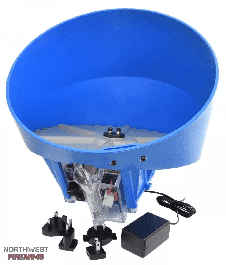

I'd like to have a case feeder, but I'm still waffling on the electric case feeder, or the Mini Case Feeder from Double Alpha. The Mini would be a lot less money up front, but would I grow tired of it quickly? https://www.doublealpha.biz/us/mini-xl650-case-feeder

The case feeder is not a necessity but... I just looked at the current prices and WOW. Did not know. I would stick with the double alpha for now till you could find one at a reasonable price or used.

I'd say start using it as is then add to it as needed. Just as a reference in regards to the subjects above. My presses are all bolted to my benches, no extra mounts. I like the shifter knob handle, it just rolls in my palm. I do have one press that came with a roller handle and it works but I wouldn't pay extra for it. I do like the case feeder, it speeds up production by about 50%. I haven't messed with a bullet feeder yet but plan to in the future. I like to sit and load so I garage sale-ed three stools of various heights to work with my three work benches.
You need the case feeder for fast production of ammo and lots of primer tubes, Primers will be a limiter to high production because you have to constantly stop to refill the primer feed, then you have to refill primer tubes to refill the primer feed. That is tedious. I used to load 5 or 6 primer tubes the night before a session, usually while watching TV and then I was set for a session the next night. Since then, I bought the RL100 primer loader. Pricey but really worth it IMO. Dump primers in the top, make sure the tube is in place, turn it on and in a couple minutes the tube is filled. Dump that into the primer feed then put the tube back in the RL100, dump in another hundred primers and turn it on. Then, while you're reloading, the primer tube is filling and ready by the time you need another hundred primers.

Get the case feeder. Once you have it, you will wonder why you didn't have it before. Buy once, cry once. The roller handle is a nice addition. Again, those that don't have one, can't appreciate it. It moves you a bit to the right when operating the press and makes it just a bit easier to do everything. More acro bins, those are handy. More primer tubes, those are handy too. Tool head stands are nice for when you get new tool heads for various set ups. The spare parts kit is really good advice. Not that you wear much stuff out, it's just that at some point, one of the little fiddly bits will shoot across the reloading room when your working on the press only to be found 5 years later when you are looking for something else that jumped off. It is really nice to look in your box and have a replacement to keep you going. Speaking of working on the press, the tool kit and mount for the back of the press is handy as all get out. Not necessary, per se, but downright handy to have those tools at your fingertips and organized.

I agree on the benefits of the case feeder far outweighing the damnable cost. Saves tons of time. And I'd rather feed each boolit by hand, as that works well for my notion of multitasking and seems to balance body movements. You'll come up with your own little tricks, you are an OPERATOR of the press....or will become one in some few hundred thousands of rounds. After 40 years with Big Blue, I'm still surprised just how fast and pleasant you can build 500 pistol rounds without stressing out.

Case feeder
