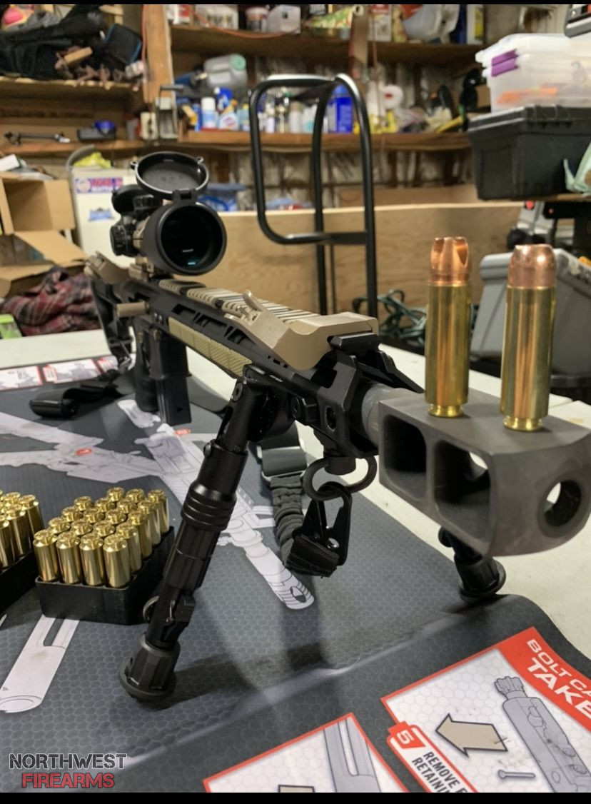

Nice...... I wouldn't even bother getting heavier buffer if you don't mind recoil. Runs fine on carbine but I do have an H2 in there. Tank break helps big.
Thats awesome! I've been dreaming of this build for a few years now. And now I'm currently sleepless thinking about making my own tank brake...
And don't bother with Alexander mags. Junk for me. They don't have anti tilt and that's the biggest issue. Very disappointed.
Milspec alloy or steel just fine. I even did some filing of pmags. Still just use antitilt milspec
