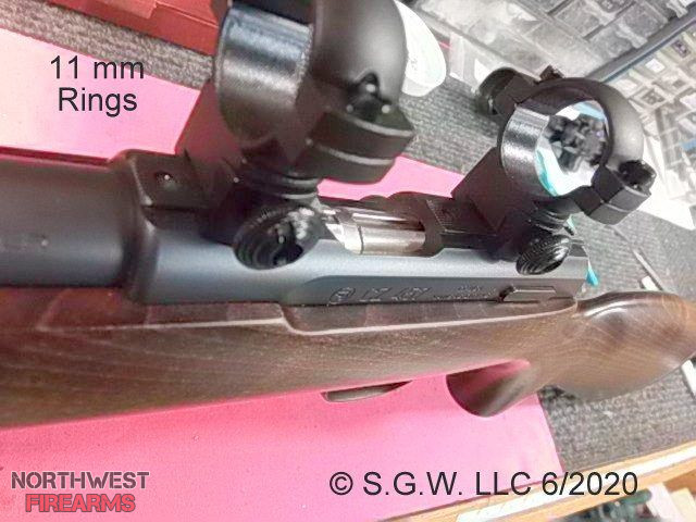

The CZ 457 LUX arrived a couple of days ago, and the optic one day later. I mounted the scope using a set of 11 mm base rings, but they were a bit too high and I didn't like how they fit on the little rail:
So, instead, I used a picatinny adapter that slides onto the 11 mm wide small rail. The picatinny rail has four threaded holes that match the same position as the four blind holes in the 11 mm wide base. The four screws provided screw through the picatinny base and bottom out in the blind holes drilled at the factory. This action pushed the picatinny rail upward to lock up with the underside of the 11 mm dovetail. A very secure and solid method for the added rail:

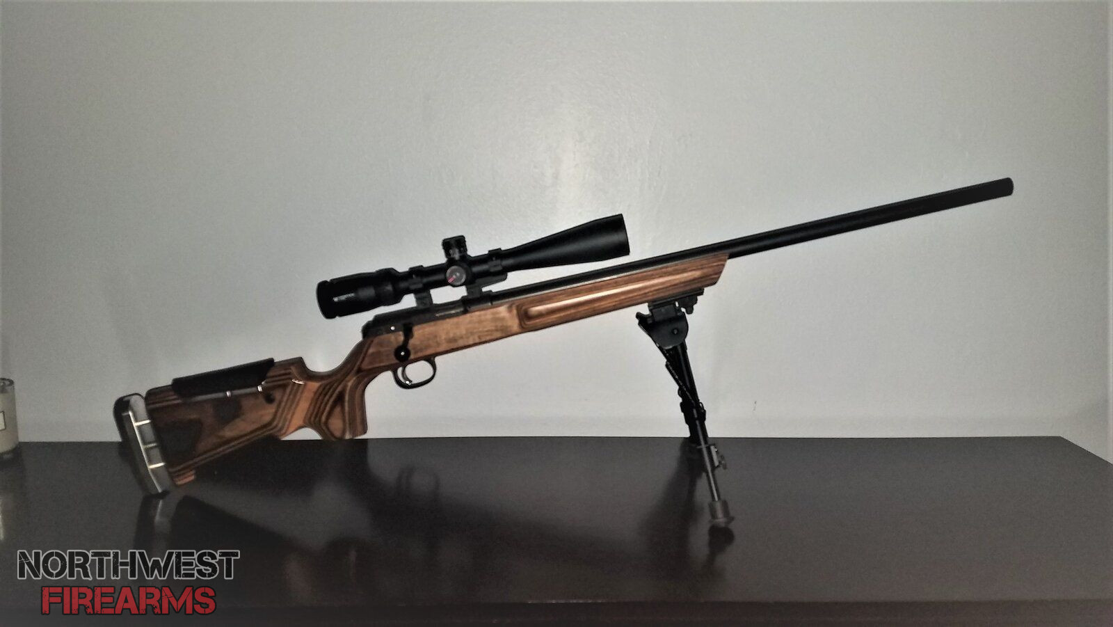

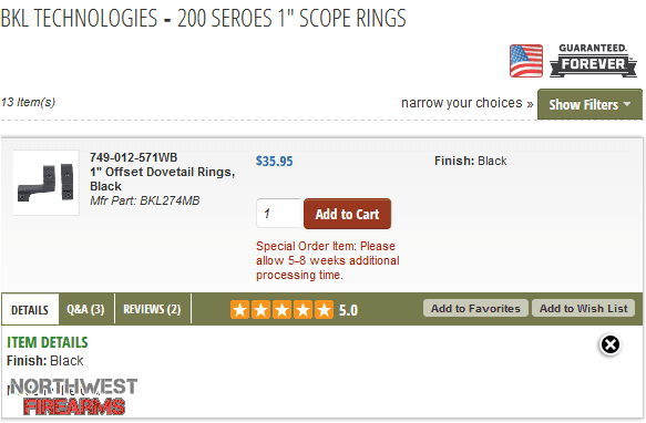

I have a CZ 457 fitted with a Boyd's At-One stock. I am using a Vortex Diamondback Tactical 4-12X40 on BLK Technologies 2-piece canted rings (from Brownells). I have not tried match ammo as the Aguila High Velocity (orange box) at $0.04-$0.05 per round gives good results: dime-sized groups. Love shooting this bolt gun.
That is a very nice lookin' stock!
Both of those setups look pretty sweet!
