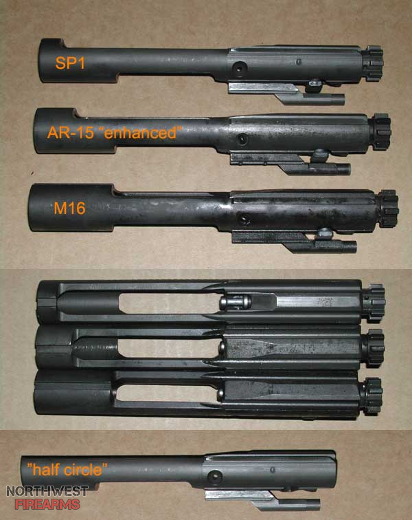

AR15 bolt carriers are a weaker design compared to M16 bolt carriers. Unless they're "enhanced" and have steel that completely covers the firing pin. This is a big weak spot and your bolt carrier cracked right in this area. They will vary on how much material is removed depending on who made the bcg. I'd guess your bolt carrier had too much steel removed.
Similar to the old Beretta M9 locking block lugs that used to shear off. And the weak spot where the slide cracks. The clones coming out of Turkey are the older M9 design. They don't have the slide stop that prevents it from flying back at you if/when it breaks.

But… it's not cracked.
