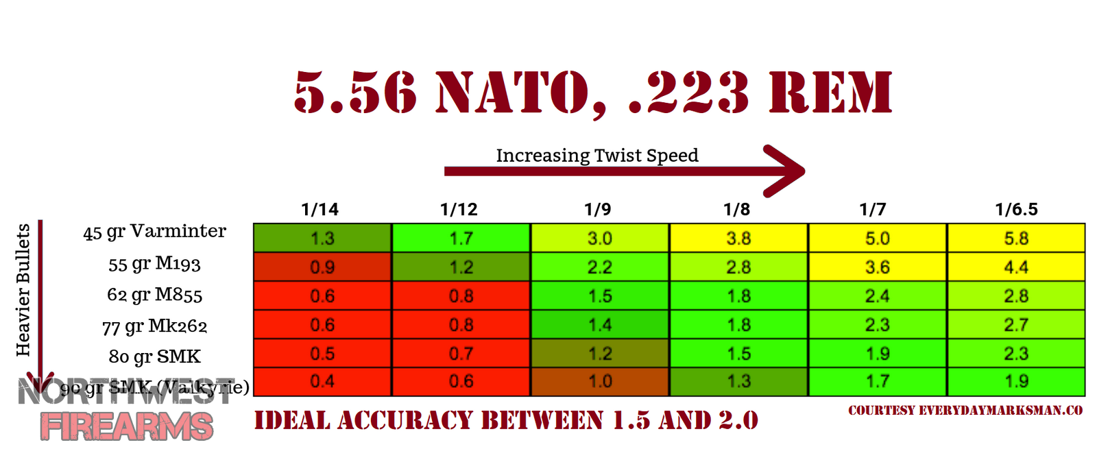

My varminter AR15, 18.5" spiral fluted SS barrel 1/8 twist, shot 52gr Sierra hollow points better than the charts would have one think... dime sized five shot groupings at 100yds.
Try Varmint bullets in various weights and see what works best for your rifle at the distance you will be shooting. If all your shots are close in, accuracy is a smaller factor.
