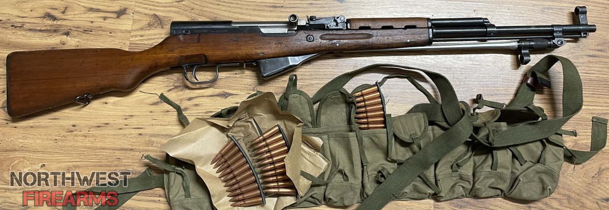

Here it is. Like I said, nothing special. The stock actually looks better in person than in the photo. A few honest dings in an old gun like this don't bother me a bit. We'll take it out to the range and try it out when I get walking a little better.
Love it. Not sure why "old firearms" like this with wood that shows the many years of service always have been a draw for me. Nice find as has been mentioned these have long ceased to be something you see piles of on cheap as in the days past.
