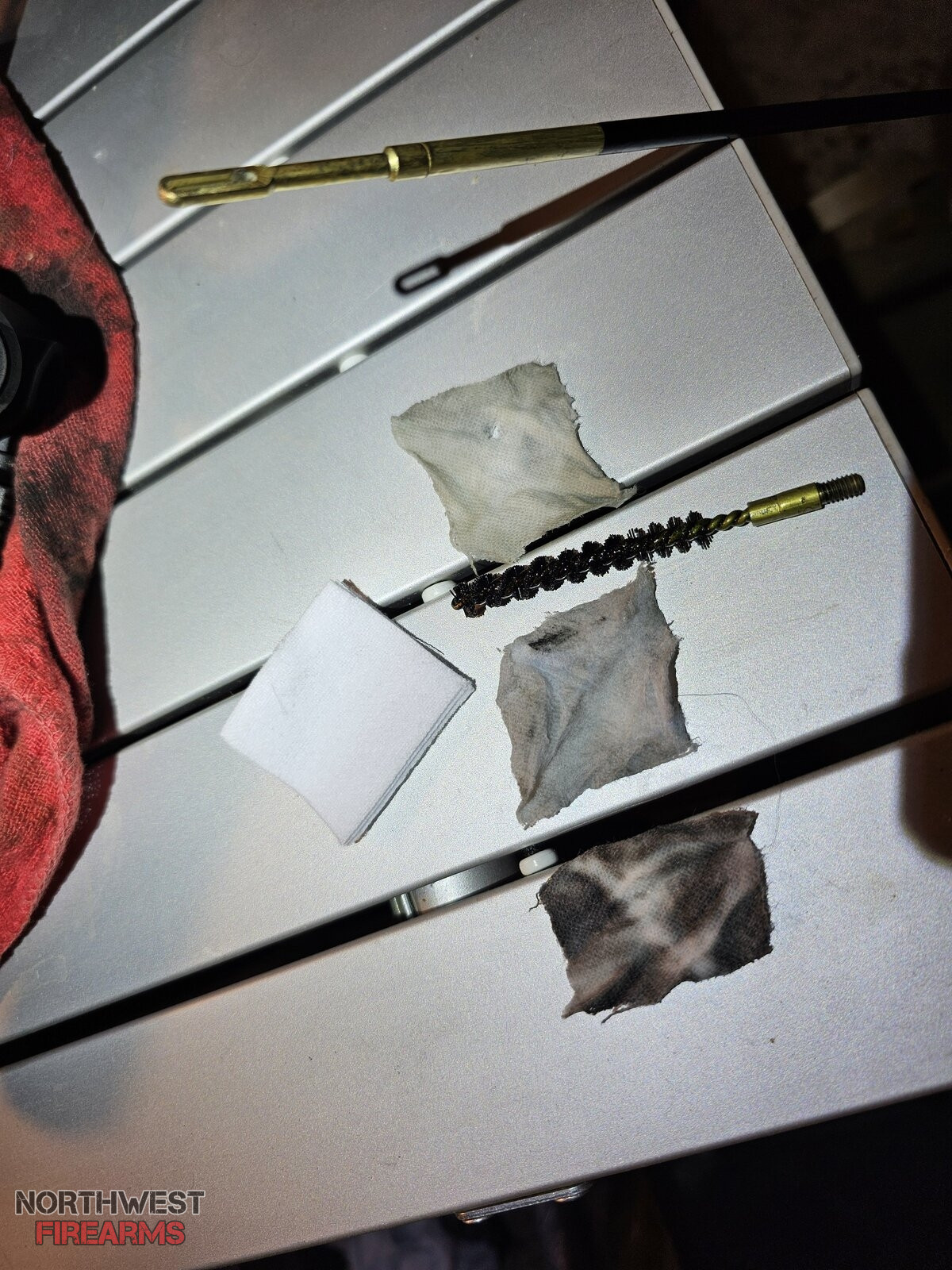

I did all that. As I said previously, I followed the directions on the bottles. After repeated attempts with the first two, very little blue was seen on a patch at any point. Only when I used the Bore Tech did I start seeing blue immediately. This is why I was wondering if age has anything to do with effectiveness of these chemicals, although the Bore Tech is just as old as the other two I used.
Bore Tech instructions advise using a nylon brush for heavy copper fouling.
Later, I was looking around online to see what comments others have about effective copper cleaning bore solvents. Bore Tech was mentioned as being effective. Sweets, Barnes, and KG12 were popular. Wipe Out foaming bore cleaner was mentioned several times. I'm pretty sure I've got a little can of that in my gun chemicals, I'll have to revisit. I didn't know it was good for removing copper or I might've tried it.

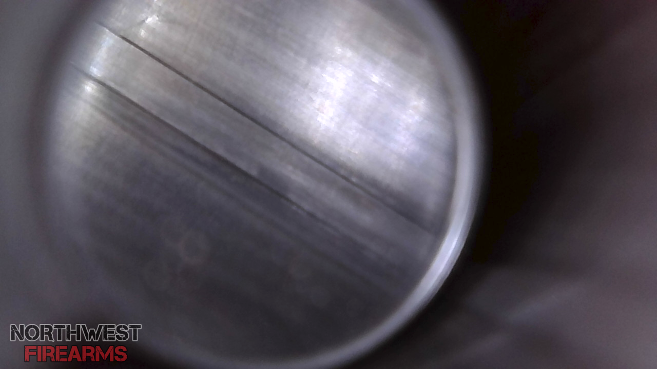

The photo of my rifle bore I shared above was taken from my cheap Teslong borescope I bought off Amazon for about 50 bucks.
And I have used it to see inside a 100+ year old rifle bore (it was really bad... )
The cheap Teslongs off Amazon work really well for the money. IMO a bore scope is essential if anyone truly wants to know how well they are taking care of their rifles....
