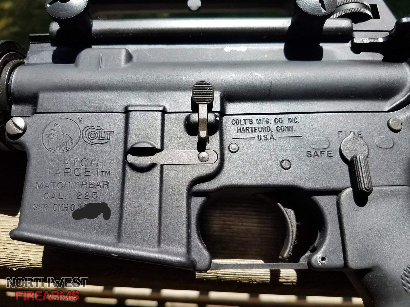

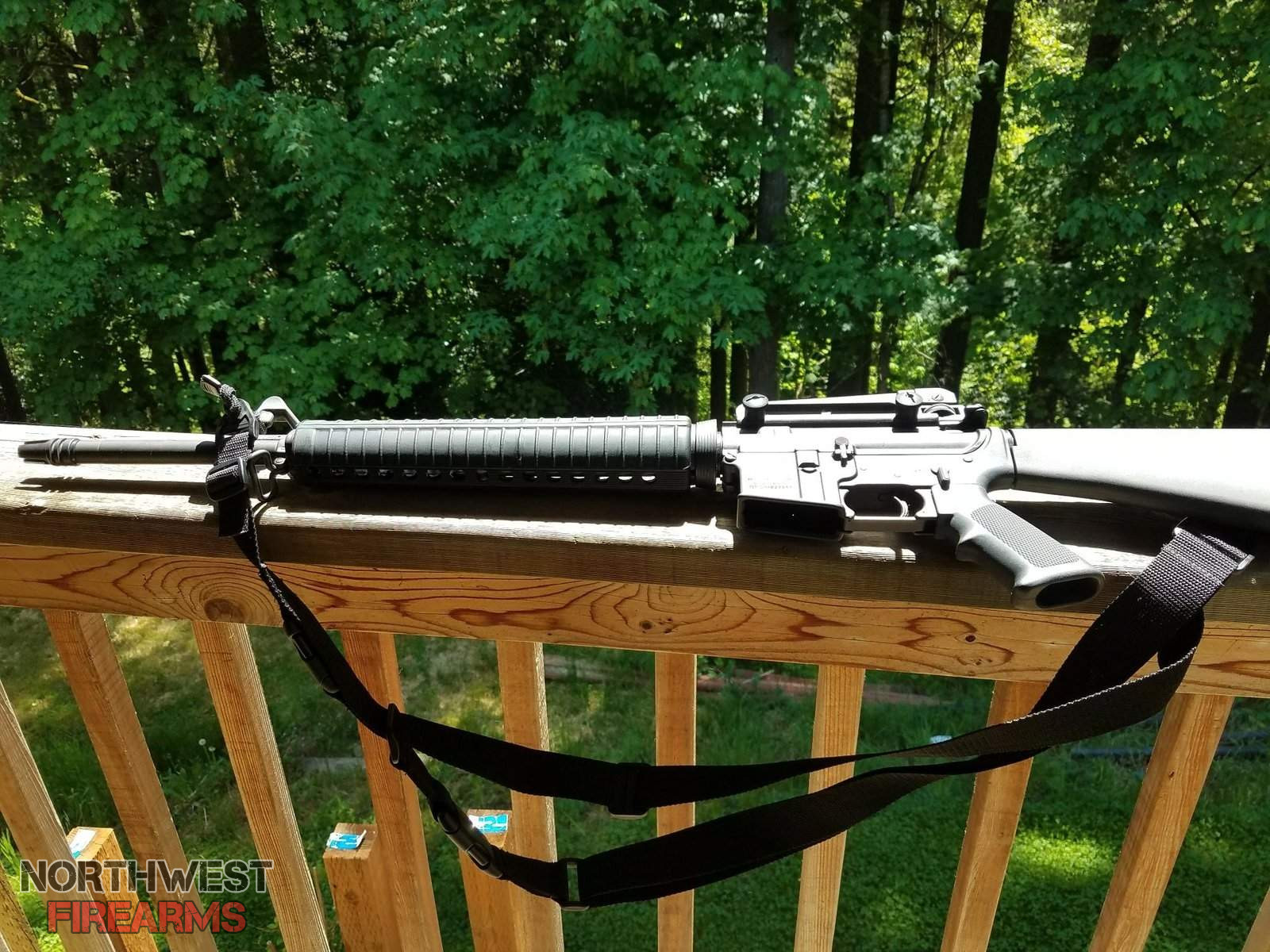

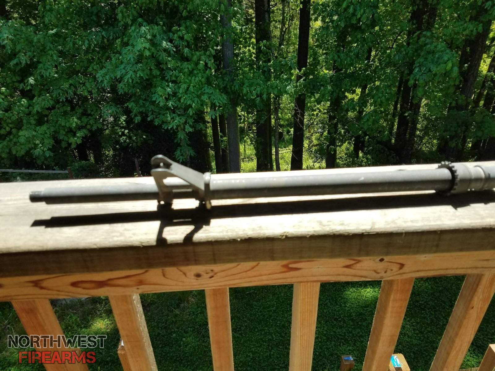

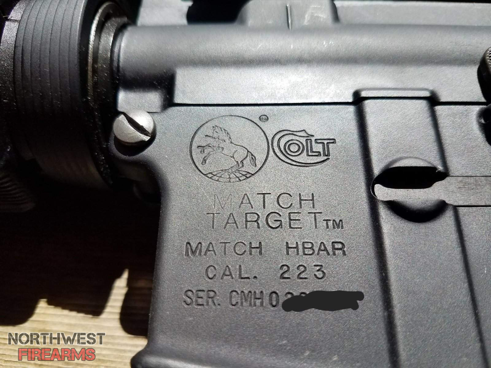

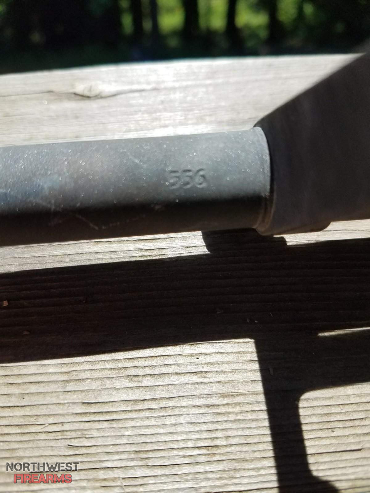

Here are some pics my brother took for me as I'm not home right now. Currently the lower has a bushmaster upper on it I got about 10 years ago in Arkansas. I'm not looking to sell or trade in any way. Just want the best and most solid platform I can make that us all colt.
Resized952017052195115400.jpg Resized952017052195115410.jpg 20170521_120556.jpg 20170521_120637.jpg Resized952017052195115526.jpg

I don't think your barrel is a colt. It should be marked in front of the sight base C MP .556 NATO 1/7 (or 1/9) Still a barrel is more valuable with a factory pinned sight base intact. Most companies are putting stripped barrels out so they can list them for less $ as a selling point and lots of guys like to customize them. looking at the marking I am going to guess Olympic arms. Who despite a lot of negative reviews makes a really accurate barrel. The biggest problem and root to most of the grips about Oly is due to that they headspace their bolts to their barrels to get better accuracy rather than going by milspec. thus requiring a mated bolt to the barrel to get reliability.
My first Ar15 I purchased back in 97-98 during the ban at a Expo show back in the cash and carry days was a Colt Sporter 2 carbine. Someone had swapped the barrel out with a oly. I was too new to ar15s at that time to notice right away but that rifle with open sites was amazingly accurate if I could see It I could hit it with the first shot. I even impressed myself with how good of a shot I was with it. It felt good to shoot it you know that feeling you get when you hit your target over and over. That's when I caught the fever.
. looking at the marking I am going to guess Olympic arms. Who despite a lot of negative reviews made a really accurate barrel.
View attachment 364721 View attachment 364722 View attachment 364723 View attachment 364725 View attachment 364724
Agree that the barrel could be anything.
A Bushy upper, oh well.
But that lower is the real McCoy....the receiver anyway.
If I had that lower, I would probably build it into a National Match compliant (20" HBAR) rifle.
These have the outward appearance of a 20" rifle but the handguard is free-floated with a special tube under the handguard.
It might be a little counterfeit if you can't find all Colt parts.
