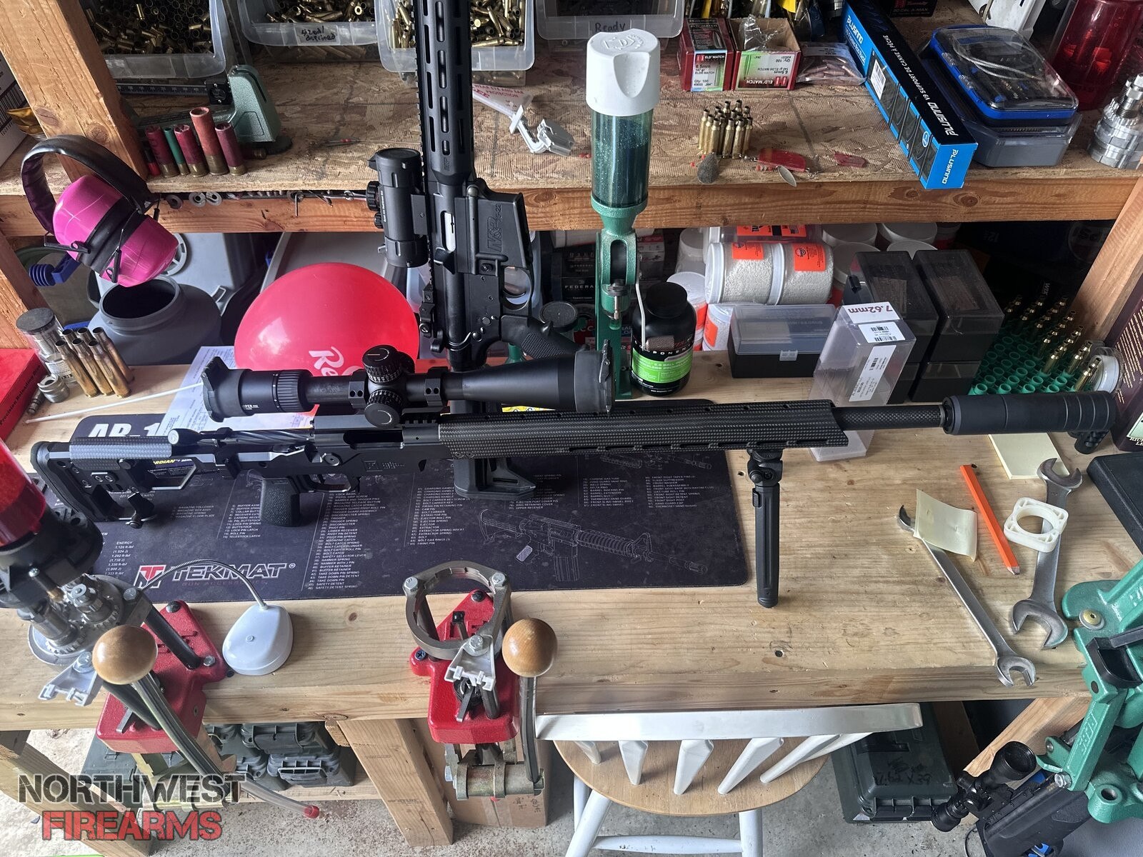

I JUST bought a MPR. Wish I would have read up on CA, first. Hunting buddies provided caliber/weight specs for an upcoming ram draw, and it seemed to check a lotta boxes (ligtweight/packable, while still packing a punch at longer range, with at least a few off-the-shelf ammo options).
Through the 30 round break-in, I've been shooting pretty consistent 1-2" (3-shot, 100y) groups simply off a bipod/my shoulder with off-the-shelf Hornady 250 Match BTHPs.
Next 20 is going to be the Hornady 285 ELDMs, before I start load development. I was planning on Berger 300 Hunter Elites, Hodgden H1000, and the fired Hornady brass, and Remington large rifle/magnum primers.
I feel like this thing will work fine for its intended purpose. But the cloud over the brand… yikes! I don't see a ton of shot strings in its future (so heating us the barrel enough to see a shift is unlikely. And I think realistically, my endurance would fail & create wild shots before the barrel). Not without a suppressor, at least!) Recoil isn't bad, but that BLAST! Oof! Muffs OVER plugs, and even then, it kinda still sucked.
Fingers crossed as my technique improves, I'll become more stable, pull it together a bit, and that the wheels don't suddenly fall off following tomorrow's session.

If it doesn't work out, im not regretting going with a proof barrel. The CA action is generally solid though some small things like the bolt knob and spring tension drove me bonkers. It just seems to be the barrels.
So far so good. Keeping the barrel in mind, just in case (love the chassis, bolt, and action).
I'm still consistently stringing 1-2" groups horizontally. Less that 1/2" vertical deviation though. All with the off-the-shelf Hornady 150's.
Had my buddy shoot three, three-shot groups. He had almost the exact same result, with one exception: He was stringing VERTICALLY, with almost ZERO HORIZONTAL deviation(!!!). So whatever we're doing… I think it's us/me getting used to consistently shouldering the thing versus anything wrong with the gun. His opinion after comparing our groups was 'it'll hunt'/good for now. We'll continue loading development, but it'll get the job done in the near future.
So practice, practice, practice is the immediate prescription.
