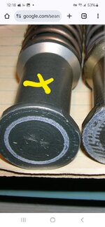

Also why is this area reduced on the exterior of the buffer.
It's to capture the spring and to make the proper length. I would avoid using anything as soft as lead but you might be able to find some low cost steel weights or make your own out of a small piece of round bar from someplace like Home Depot.

You sure about that? The shoulder that holds the spring could be the same diameter all the way to the end and function the same except for being heavier. The pencil lead/tape would be shy of the full diameter and not touch the buffer tube so I don't see a problem with lead being too soft.

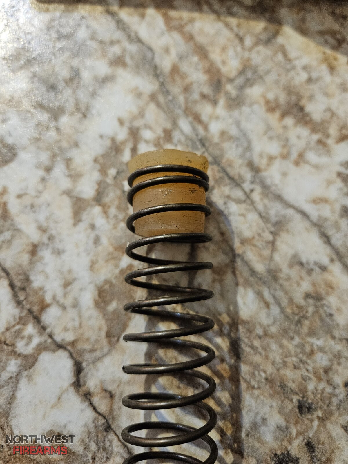

I also added a silicone plug to the butt end of the buffer spring. When the bolt is pulled all the way back it is now less than a 1/4" from the bolt catch. Without the silicone plug the bolt traveled darn near an inch past the bolt catch.
