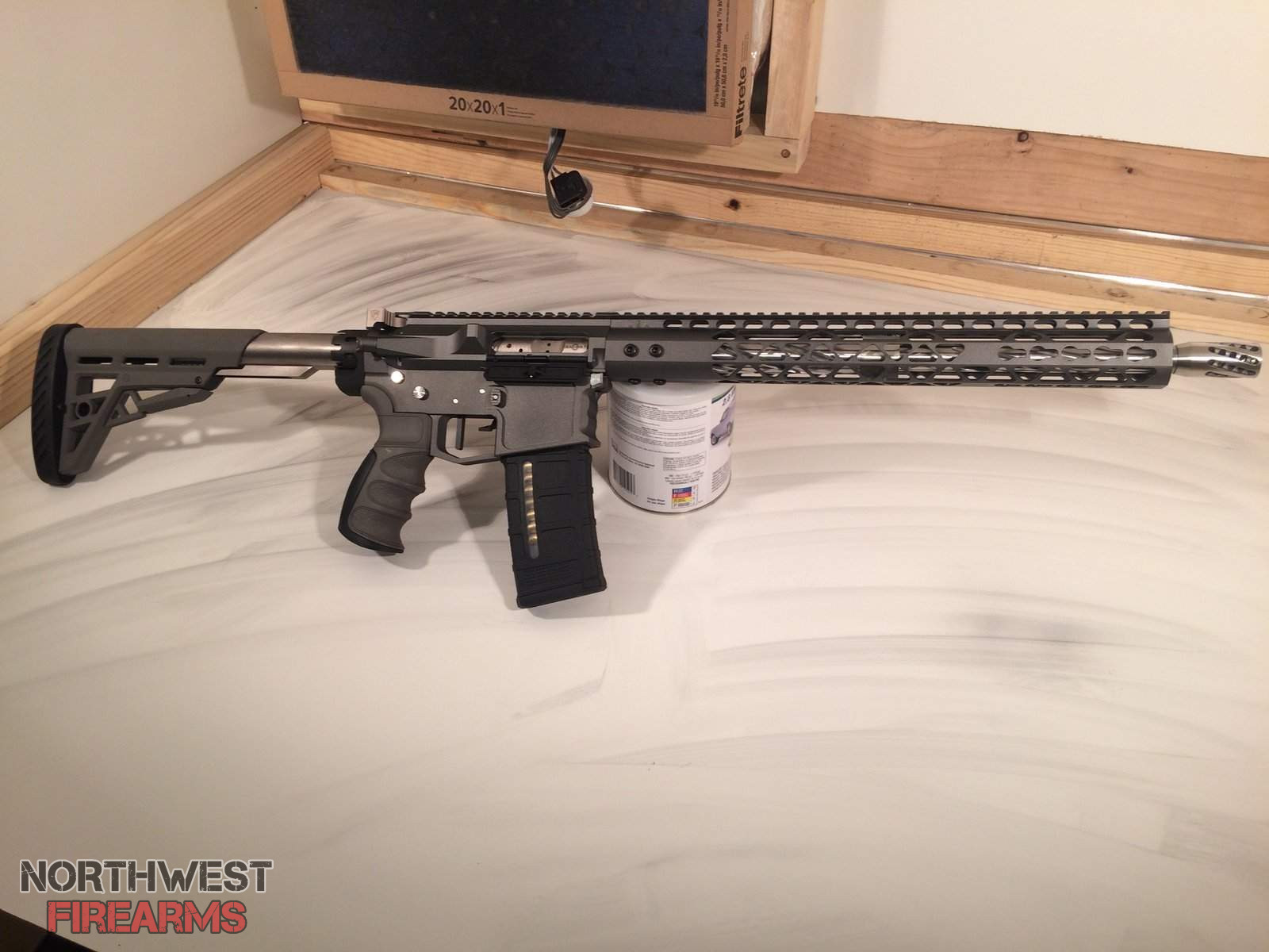

With the right tools you can do the job like a pro. And these tools you can use forever , no throw away crap from harbor freight. I purchased a Devilbiss startingline touch up gun, charbroil 30" electric smoker , and I built a backdraft paint booth. The spray gun is everything, .08-1.0 tip and the gun paint adjustment is easy to put the perfect atomized the paint perfectly. Make sure you purchase a good water/oil seperator for your compressor.
Here is my first rifle I just finished and plan on doing many more.. tungsten metallic

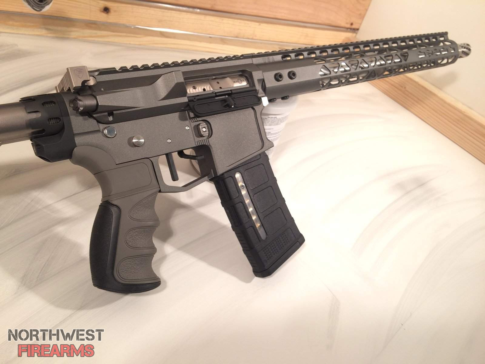

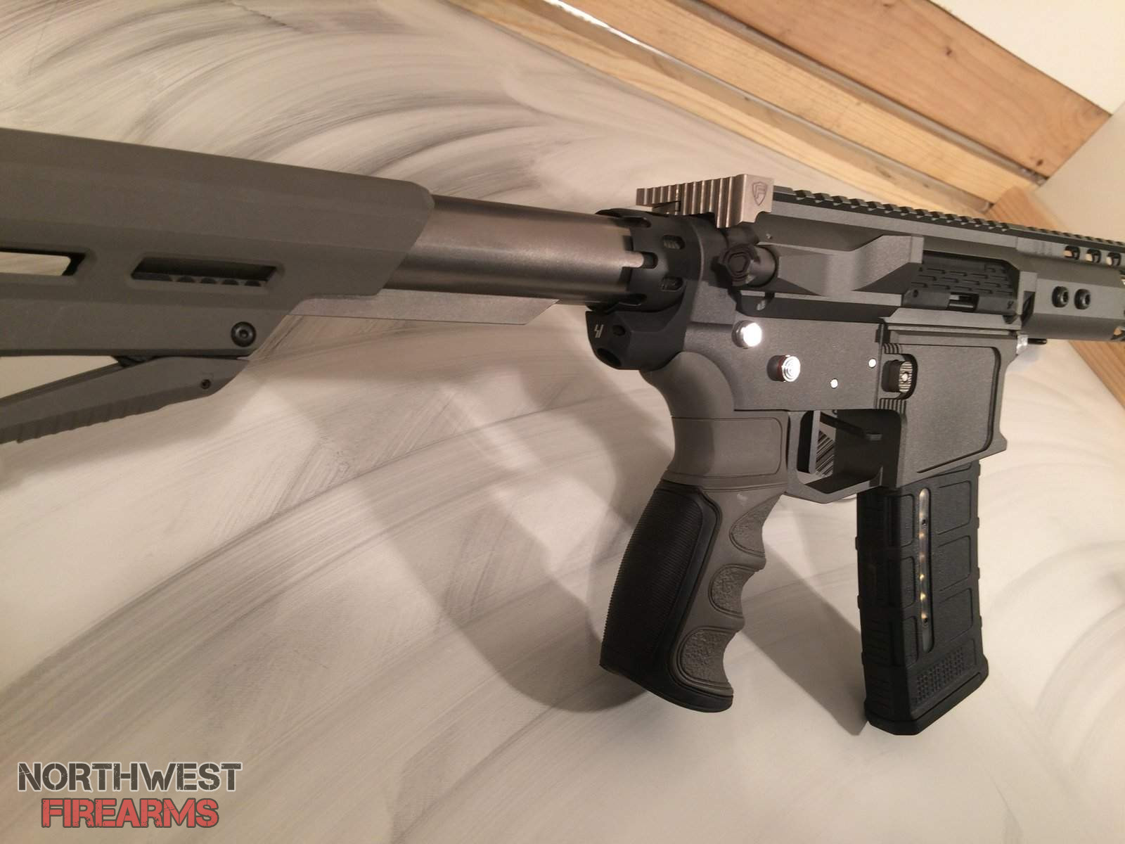

No I didn't. That's ATI, took me forever to find that color. But I have cerakote'd a few plastic parts, just as easy as the metal parts. Just bake at 150 not 300 plus.
Very nice! Did you ceracoat the grip too? I wonder how durable that will be long term. Interesting cross-slide saftey!

Looks DAMN nice. You could no doubt get the money back doing some of these for others.

Looks good, OP.
