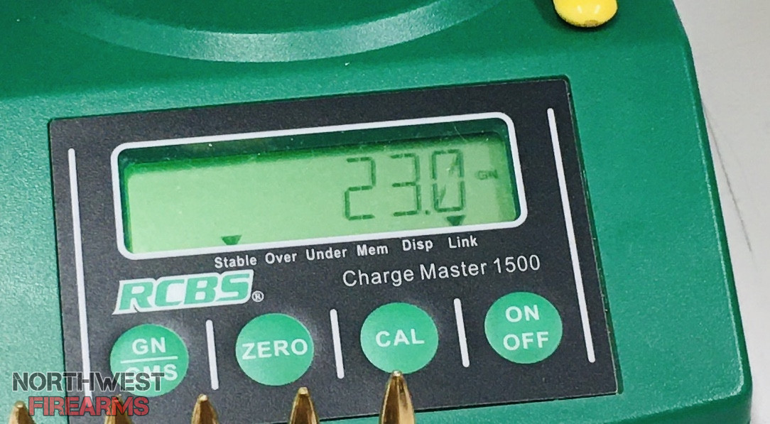

I load .357 ammo to the 'last trickled' but only because I shoot some of my .357 out of my Henry rifle and want the best accuracy, and do the same with my rifle ammo.
Now, my 9mm and .38 Special gets hopper thrown charges and even when shot out of my PCC I get excellent accuracy.
Loading pistol ammo I do not weigh every charge but when it comes to my bottle neck rifles you bet your bubblegum that I will make sure each one is what's intended.
I've seen squibs and blown up ARs from no powder in the cartridge. That will not happen to me.

I'm pretty anal about my powder charges. Pistol I weigh about every 8-16 charges. Rifle charges that use stick powder I trickle to the exact weight with my eye on a RCBS 5-0-5 scale. I like loading .223 with H335. I weigh every 8-16 powder drops.
