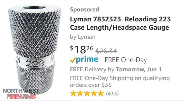

are Case length/head space gauges all about the same/equal I am looking to get a Lyman's length/head space gauge for $18 (looks like normal price is $21-27) But was seeing others for like $30ish
Range Dillon jp oh except hornady was also $18ish down from $21

Do you mean quality wise?
I couldn't/wouldn't say one brand vs the next has a "better" tolerance. I'd hope that they were all made to the SAAMI specs. But, QC of one brand vs another and one dies vs. another even from the same mfn....Ok, ok, ok.....ME, I'd just choose a brand and buy it. WARNING: You'll still need to be aware of the chamber "differences" of your own rifles.

Yesterday I ordered a Lyman gauge should get it tomorrow. But when I was ordering it I saw a ammo checker which checks to make sure your case will fit the chamber (sammi spec) not head space but it seems if you have your die adjusted low enough on the case you should be ok but with that being said wouldn't that also apply to head space

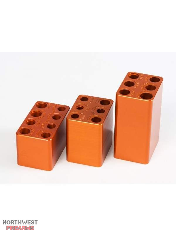

I have the Lyman set that has multiple calibers per block.
I haven't had any issues on the calibers I check. In fact they have saved my bacon a few times.
Yes, I use all three and it's glorious.
The Lyman gauge shouldn't really be called a "headspace gauge" by definition. It's checking the cartridge dimensions against SAAMI min/max dimensions, but does not measure the cartridge dimensions compared to your chamber dimensions.

This tool, the Hornady headspace comparator, or an RCBS precision micrometer would be the best way to actually check the headspace of your rifle.
You take a once-fired case that was fired out of your specific rifle, measure it with the comparator or micrometer, and then set your sizing die to set the shoulder back 0.001-0.003". This may or may not fit your cartridge checker or case gauge, but it is properly headspaced for that rifle.
If your rifle has a very generous chamber, this may be larger than SAAMI specs. If you were to resize brass to SAAMI specs for a rifle with a generous chamber, you are actually creating unnecessary and excessive headspace for that rifle, which will likely shorten the lifespan of the brass.
On the opposite end of the spectrum, a rifle might have a chamber that is right at minimum SAAMI dimensions, or possibly even undersized, especially if it is a match chamber. In this case, you can size the brass to match the chamber, but then may have slightly more headspace when using that ammunition in a standard SAAMI chamber.
Where the Lyman case gauge and equivalent comes in handy is when loading for multiple rifles, where you are better off loading to SAAMI dimensions rather than specific chamber dimensions.
If you're looking to check the actual headspace of your cartridges to your rifle, the Lyman case gauge is not the right tool for the job.

I should have clarified in the Lyman product. It's an ammo checker, not headspace gauge.
