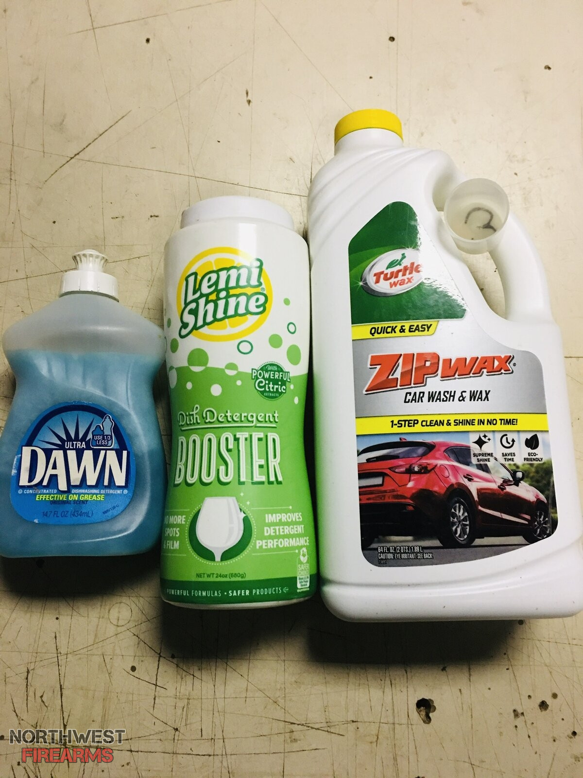

This is my concoction but I do not always use the car wax.

I was having some problems with wet-tumbled brass (using Dawn and Lemi-Shine) tarnishing after a couple of months in storage.
When I dry tumbled, the brass polish I put in the dry media stayed on the brass and kept it from tarnishing.
My research pointed to the wet-tumbled brass NOT having any protective coating left on it after wet-tumbling, thus increasing the chance it would tarnish. The recommendation was to ad some liquid car polish / wax to the tumbler with the Dawn and Lemi-Shine (as @Caveman Jim recommends above). The polish leaves a coating on the brass to protect it from oxidation.
Seems to work - at least for me.
Question on the car wash polish, does it leave a residue that powder will stick to? On my Dillon I like to check powder every 15 cases or so.

When wet cleaning it's all about using the right amount of ingredients. I cleaned a lot of brass the last two years and finally figured it out to be hot water, 3 laps with the Dawn, a 9mm case of Lemi-Shine and 3) 35mm film containers full of liquid car wash/wax running it 1-1/12 hours max.
Rinse with cold water then run them through a media separator to get the excess water from the inside aids in less drying time.
For pistol cases I use the wash/wax because it makes it easier to size, even with the high end precious metals sizing dies of today.
Rifle cases don't get the wash/wax since they are already processed, including primed before they hit a loading press. ;)
I use Armor All Wash & Wax. After handling a few hundred rounds with rubber gloves on, you can feel the slick. I have brass that's been tumbled for over 2 years and it is slightly darker, but still shiny. Kind of like store bought ammo.
