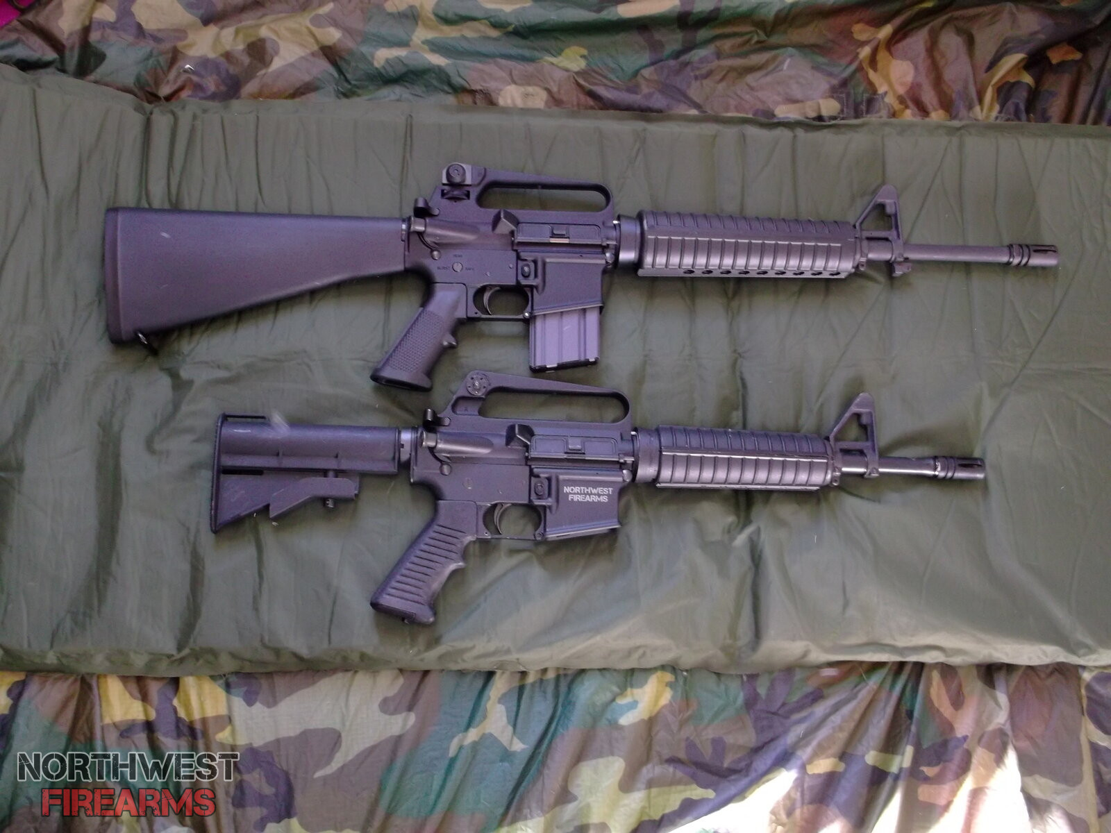

All three of my ARs are assembled, with the first and second one having been barreled by a gunsmith.. the most recent one I bought a vise and receiver block to install barrel myself.
Two 16" barreled builds, 1 a M16A2 carbine Midlength build inspired by Armalite's M15 midlength and RRA LAR-15 Midlength, and the other started as a standard M4 Carbine 16" kit from Sarco, most recently swapped front sight base for a YHM low profile clamp on gas block and installed a Dez Tactical set screw front sight base at rifle length with pawnshop handguards (PSA likely? Maybe DPMS fat), inspired by Bushmaster's Dissipator setups from the AWB/post AWB era.
12" 6.5 Grendel C7 commando, started as parts and pistol braced then registered as SBR during the amnesty.
The Dissipator and C7 Commando both have Anderson lowers, the M16A2 Middy has PSA's M16A2 marked lower.
