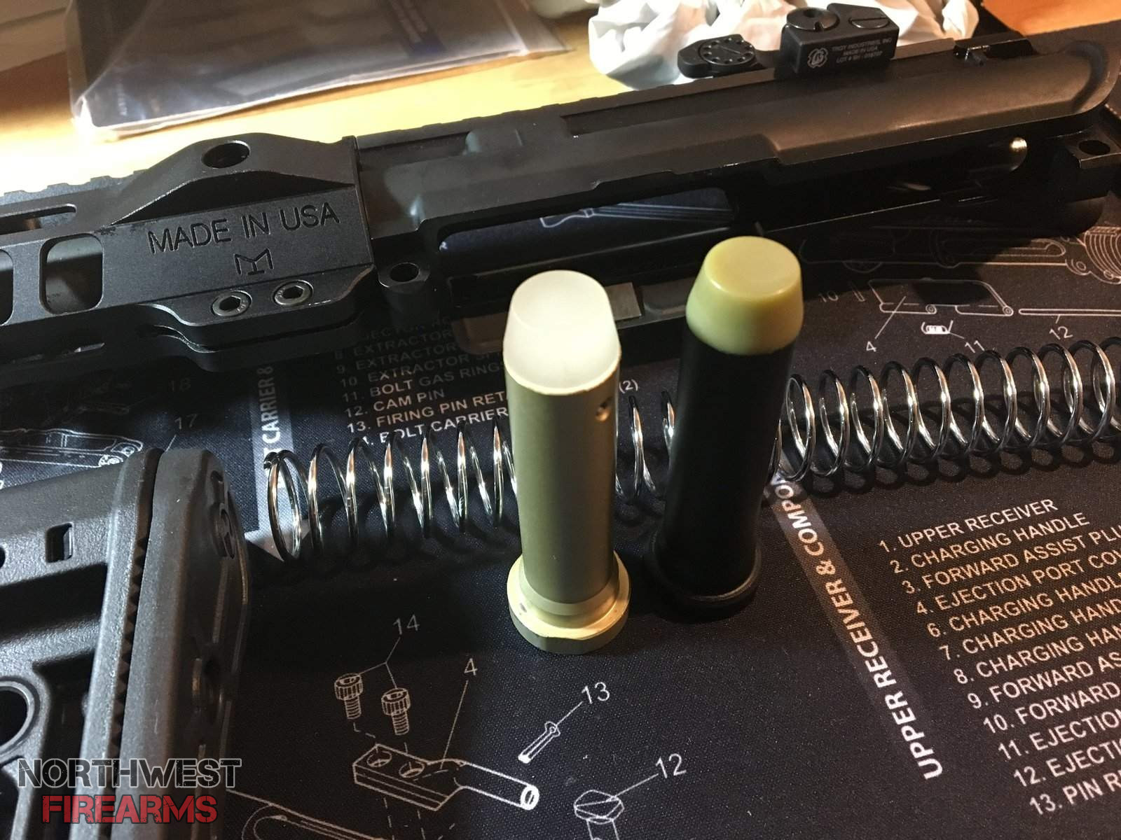

My other build which I bought a chromed lined 18" upper and I put some Troy flip up sights on it. My lower was a complete BCM lower parts and included a fire control group as well. I bought buffer tube, buffer and a the spring in one package. It has a carbine buffer so I just but that one into the buffer tube. I fired one shot and bolt locked back. So I tried again and bolt locked back again. So I swapped the carbine buffer with an H2 buffer instead. Had the same results I fired and bolt lock back with the H2 as well. some buffer springs as well.
Do I need a heavier buffer? The BCG is nickel boron which I bought as well. Have no experience with s nickel boron BCG. I can try a phosphate BCG in instead as well.
Carbine one is on left and H2 on right. One thing I notice is I can hear the spring moving.

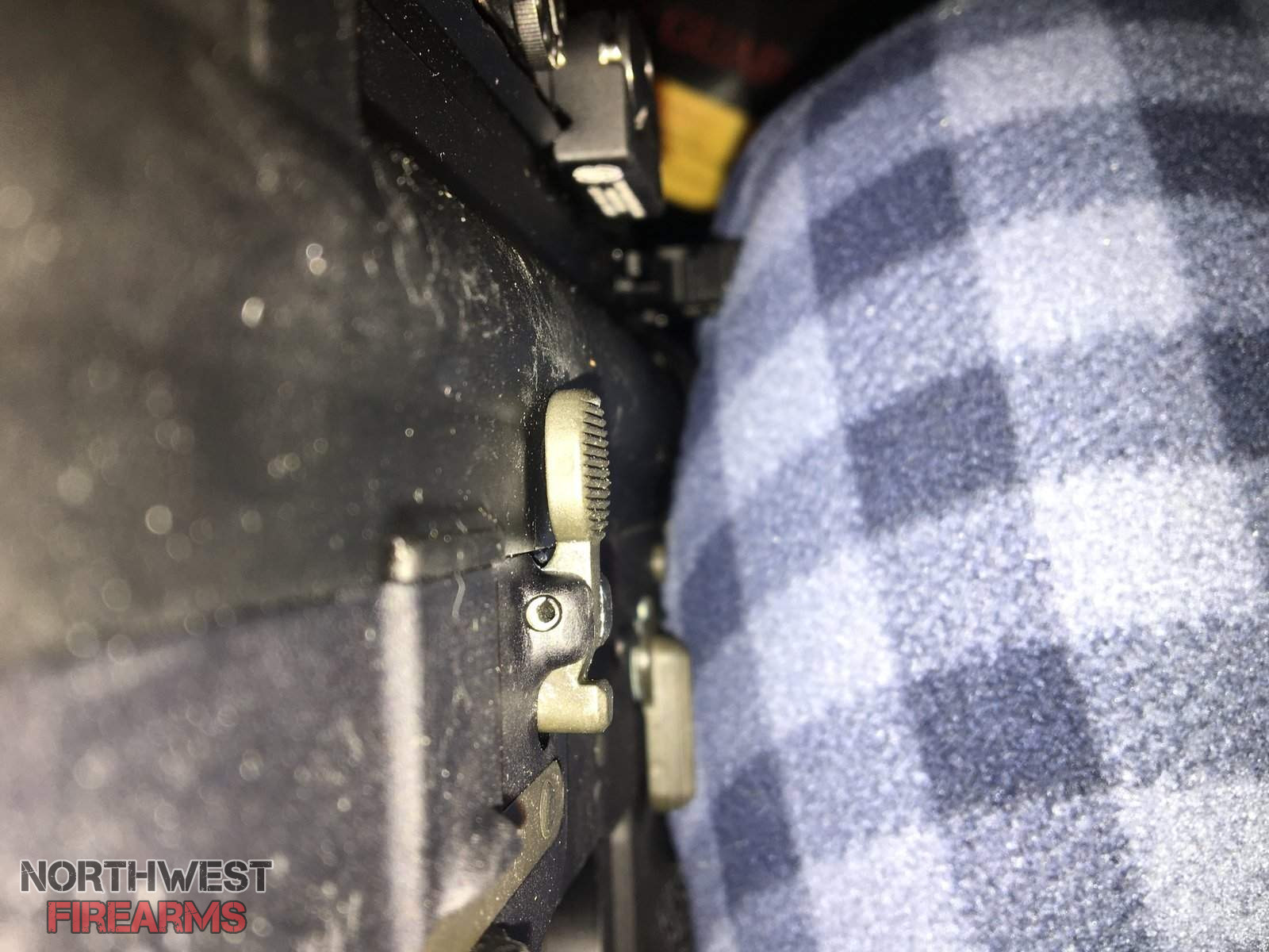

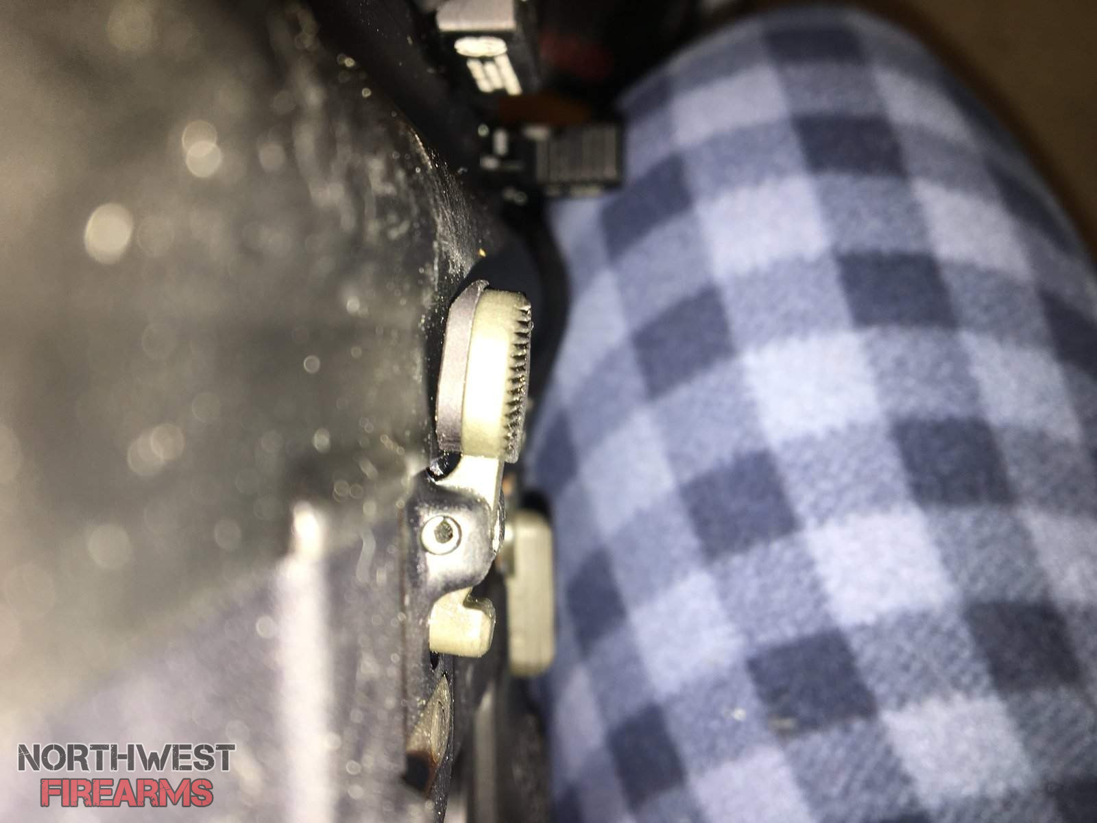

Were you able to see exactly what the BAD lever was doing to cause the problem?
With the BAD lever on bolt lock it pulls the causing the bolt lock to engage.
C24DFAA7-FAC0-4D1E-953A-94C8E2AC37D2.jpeg 5A1EFCA4-6D57-4AB5-B620-6F46EF4F3AEC.jpeg
I am right handed and I bought the BAD levers for both factory made rifles and both work fine. My home built ones the FDE the BAD lever works fine the other does not. For HD I will reach for my factory built AR or my FDE one.
I've had BAD levers on my rifles since about 10-12 years ago...never a problem. I've heard of problems with them, but haven't experienced any, so have always been interested in what problems people have had.
From the pics, obviously not enough clearance behind the paddle. Might try a one piece style?

Might be able to sand off a bit of the back to get it to clear.
Or like Cerberus said get a one piece.
