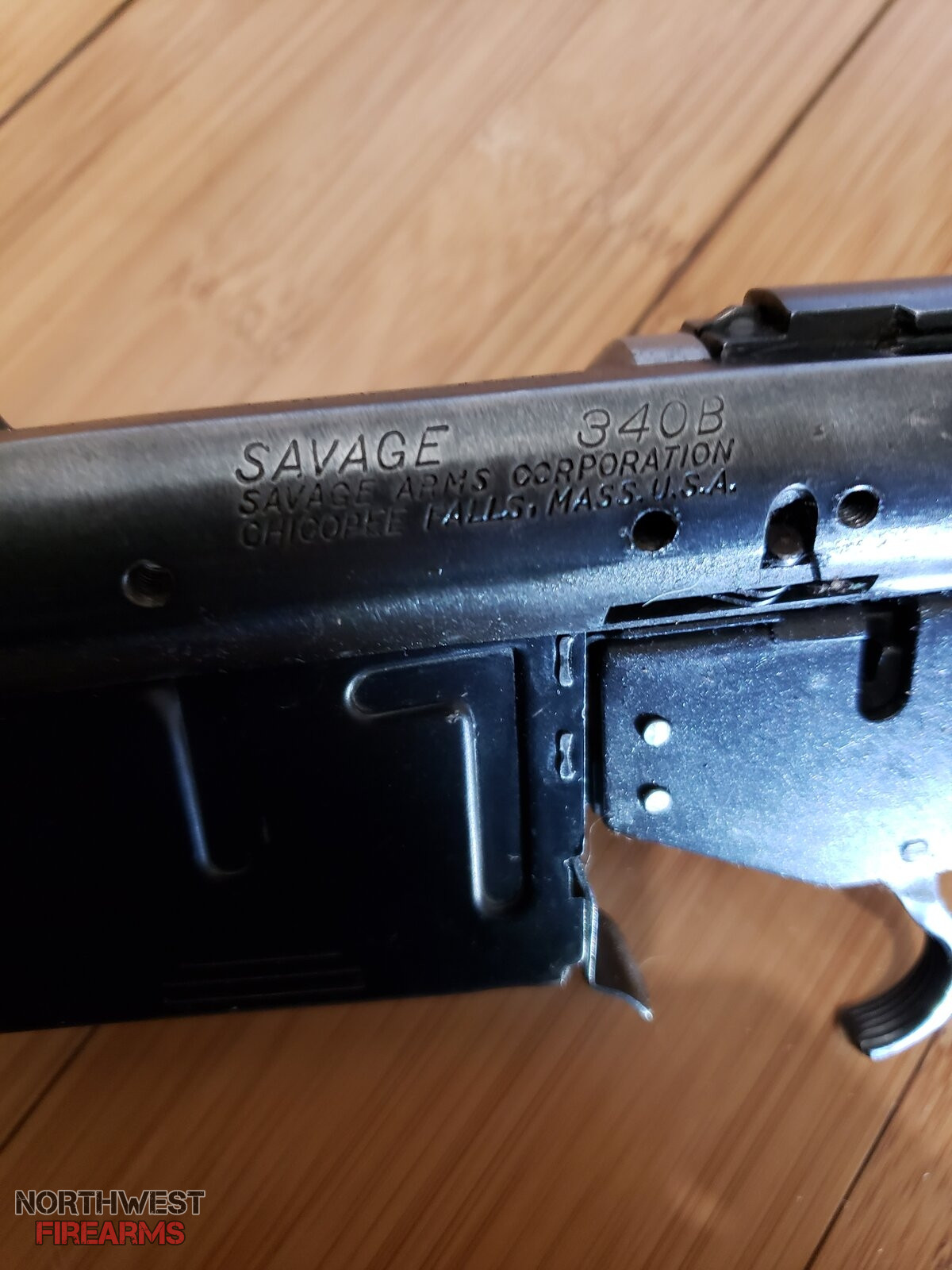

Could be a Savage 340...or one of the Store Brand / Marked versions of the same.
( Stevens made a similar one as well )
If it is...any of them that I owned...shot very nicely....albeit none of them are worth a whole lot , dollar wise.
Andy

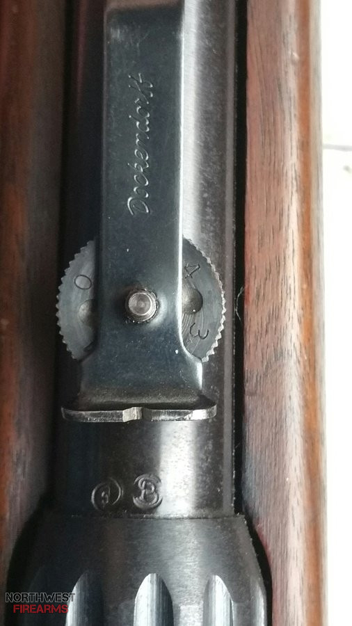

Savage Stevens date code , letter in circle.
A 1949
B 1950
C 1951
Etc.

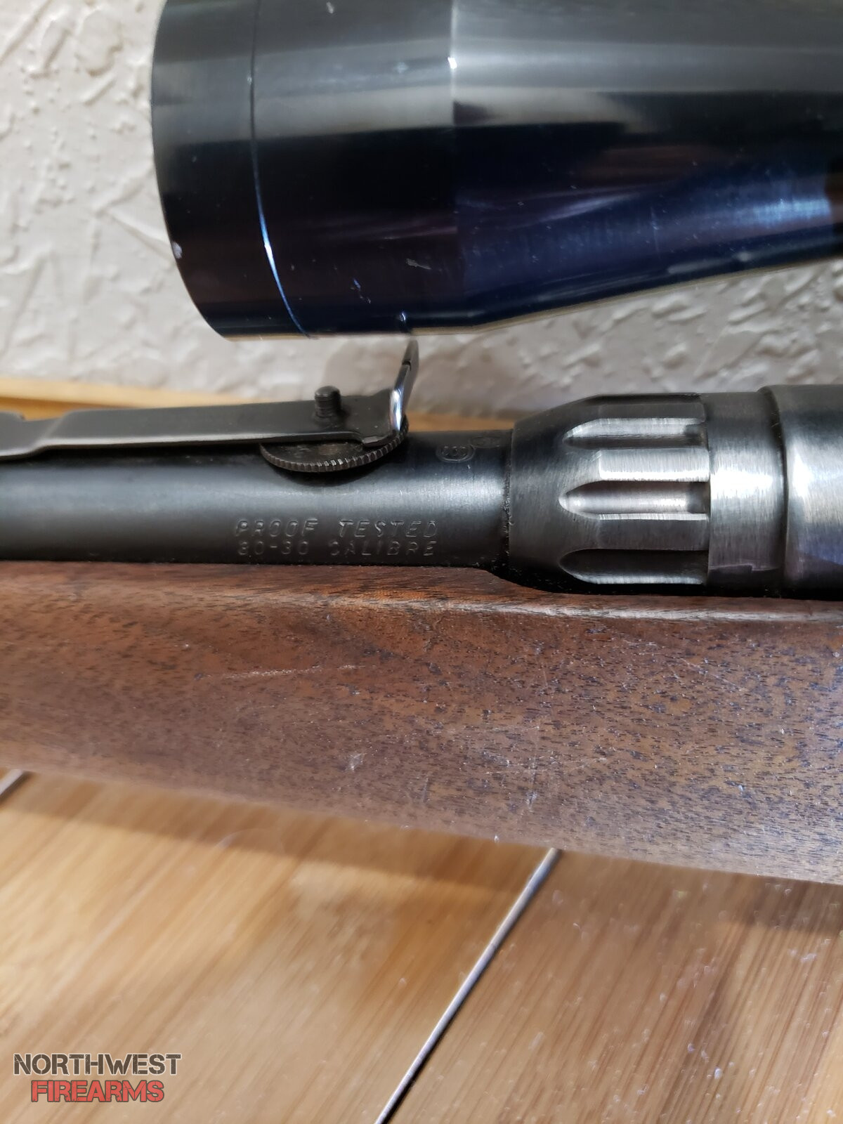

Some photos of my 340B. It is an accurate rifle, but what I really like is being able to shoot pointed fmj bullets. I do like my tube feed lever actions more, but its good to have more options than RN or FP.
View attachment 1245474 View attachment 1245475
Yes, I've been thinking about loading something like a 165gr. BTSP in a .30-30. Would probably increase its effective range out to 300-400 yards.
I think Gent's brother has either a 340 or a 325, or a varient of one of those.
