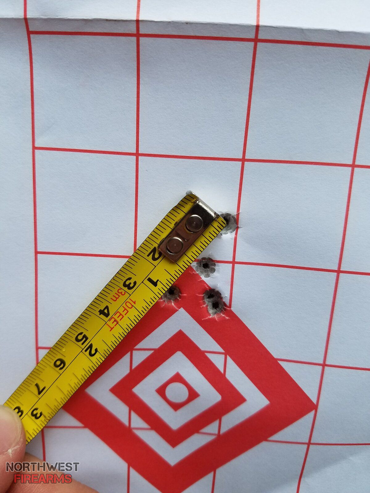

This is a sight in group at 100 yards with surplus 55gr ammo from the 20" 1:8 5R. Called the first one high right, but was going for a 2" high zero.
