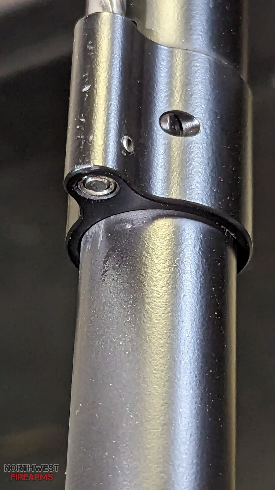

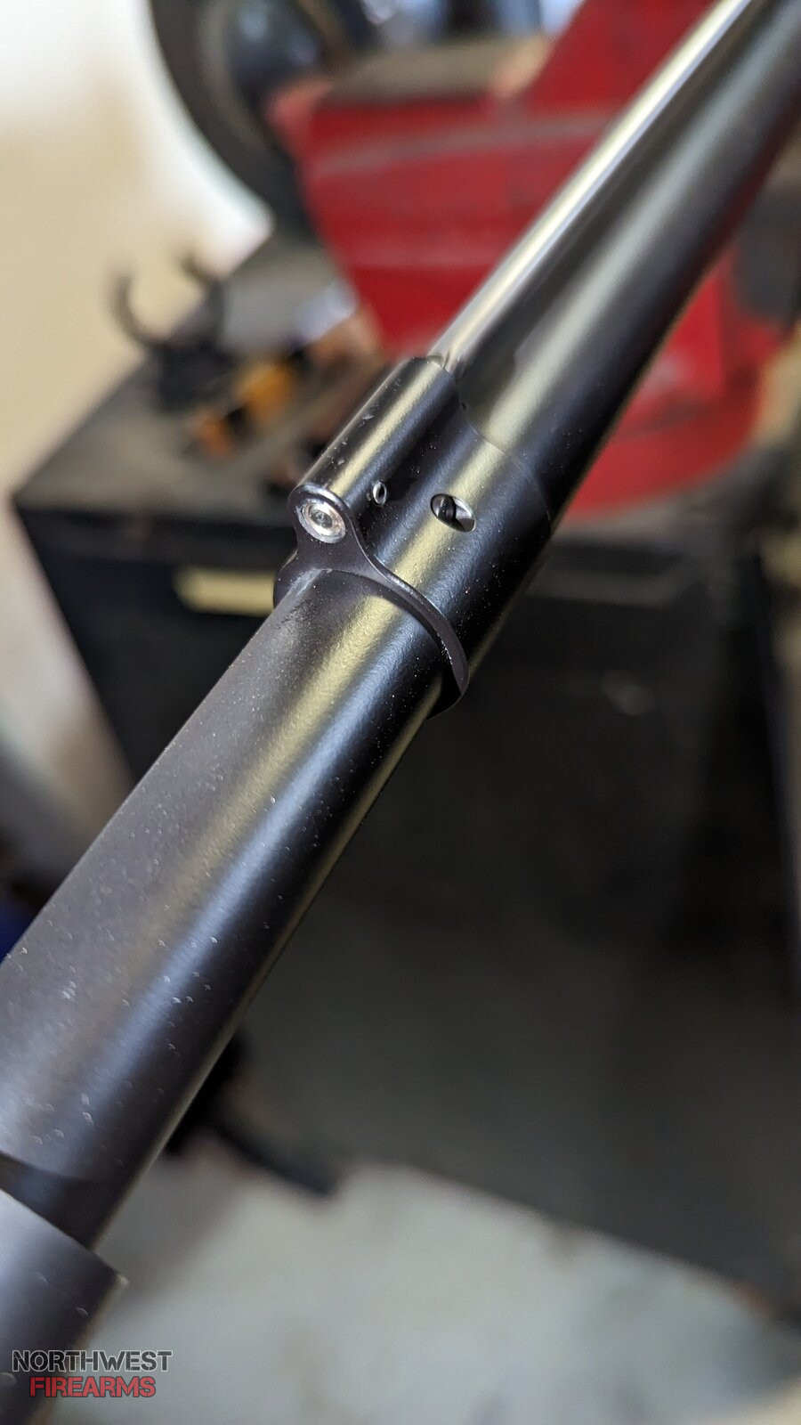

After about a year of gathering parts, I finally built this rifle and test fired it. Unfortunately, it seems to be under-gassed. The rifle will fire, but no more than 5 times in a row, will often not strip a round off the mag, and it will not lock back on empty. It is ejecting spent cartridges. My biggest concern is how to validate whether or not it was the gas tube installation or if the pinned gas block is the culprit, in which case I would have to send it back to Centurion arms.

Those barrels have a notch on the barrel and a tab on the gas block for alignment.
The gas port size is listed at .076", perfect for a 16" middy and should run well with a blue spring and H buffer or an A5H2 buffer and green spring.
A new pin is probably 50¢ from Tacoma Screw, drive it out, scoot the GB back a bit and measure the port.
You'll be able to see if the notch is directly behind the gas port also and not off to one side or the other.

It's bleed off. It reduces the amount of gas going into the carrier to what is necessary.
If you're implying that it's an adjustable gas block with bleed-off, you are incorrect.
OP, most gas blocks take some time to seal up, depending on fit. That one looks excessive, but will probably still seal.
