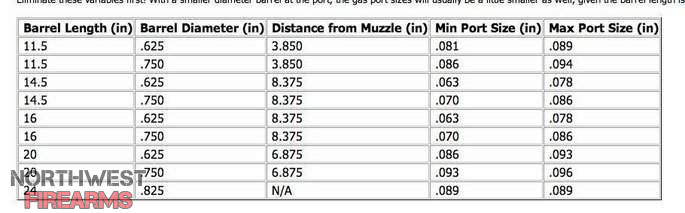

that being said, i have an issue with a recent "heres a bunch of parts i bought, build my rifle for me" super bubblegumin rifle length build i did for a friend. all parts are what i consider to be of top quality but, it does not cycle (short strokes) with .223 or 5.56 ammo. it is a 223 wylde 18" ballistic advantage SPR barrel with a rifle length gas system and carbine buffer tube with a carbine weight buffer installed currently. i have double and triple checked the gas block(adjustable), checked the gas rings, gas key, gas tube...everything. everything except the actual size of the gas port. my question is, should this gas port be in spec, is it possible that the dwell time is just too short for this setup and i may need to drill/ream the gas port(last resort,honestly) to a larger size beyond "spec" ?(i believe its .093-.096?) i may be wrong but i have considered swapping to a midlength barrel to prove this theory of mine. would like to know any thoughts? ideas? thanks!
Saved this from another thread.
