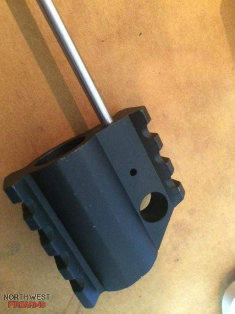

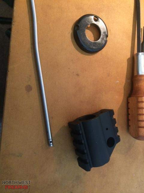

Hey all,
I have a dumb question. This is my first build and it has been going great till now. I am stuck with a low profile gas block with a non-free floated barrel. I attached the barrel and torqued as stated, but the gas tube does not coincide with the holes in the low profile gas block. Not only that, but I don't have a roll pin to even pin it in place. All I got was the gas block, tube and round washer-like thing that I'm not 100% sure on. Please don't laugh. =(
Anyway, here's the pics:
As you can see, the hole that looks to be for a pin doesn't like up with the tube... Anyway, I'm not 100% what to do, so I thought I'd ask here. I've searched all over trying to figure it out and I just can't.
Thanks for any help!
If the gas tube will not line up with the block when it is in the receiver, the gas block is off spec. If the tubes pin hole does not march up to the hole in the block for the roll pin, it is again off spec.
Sounds like a cheap gas block. You may want to invest in something a little higher quality. Not all gas blocks are made equally.
Yeah looks like you got a chinese lame production run.
Either take it back or just trash it.
