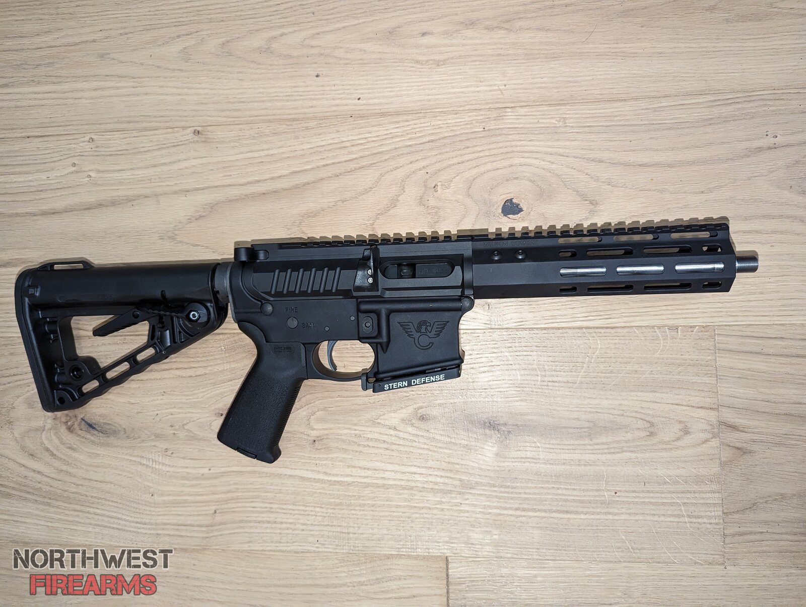

I have a Stern Defense mag well adapter so I can run Beretta 92 mags. It works great, but is almost $200.

Stern makes adapters for both. I have one to convert a regular AR lower to accept 9 and 40 glock mags. A friend has one to convert to S&W mp45 mags (they don't make a glock 45 model due to width problems). Both function well.
