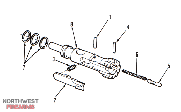

I'll take a crack at this one:
Looking at the diagram above, parts #1 & #4 are retaining pins. If they are interference fit, do NOT reuse. Purchase new pins. Under some of the extractors a rubber 0-ring is used along with part #2, this might not be compatible with cleaning solutions. Dito with any O-ring.

Foreverlost,
1 and 4 are solid pins and are reusable.

The key word is "interference". If a pin punch is required to remove, driven out.........with force, I'll kindly suggest, do not reuse. Some of pins used are not perfectly round. Being a softer metal than the bolt, little harm is done to the bolt. The irregular shape keeps the pin in place.
Just noticed new post, "roll pins"! Bet they require to be driven out? Ask yourself how much damage to the firearm if they move. Roll pins are cheap. I would not go overboard removing them twice a week.:D

My mistake, the ejector pin can be either roll or solid, and are not interchangeable with the extractor pin.
Punch them out carefully, they can be reused...the secret is to get the ejector lined up with the pin hole.
