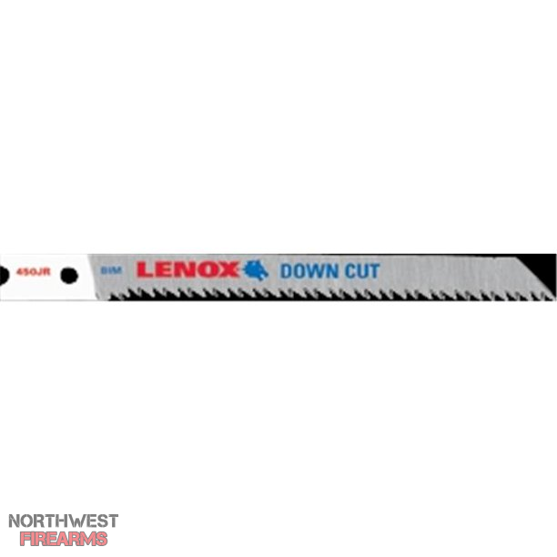

I prefer the downward cutting saw blade teeth on my Bosch jigsaw. It gives you more control while you hold the work piece, instead of pulling the metal upwards with every stroke with the old style blades.
Your best bet with tools on hand are the jig saw and the Dremel.
I have a Bosch jig saw and with the correct blades (as mentioned above) they do very well.
