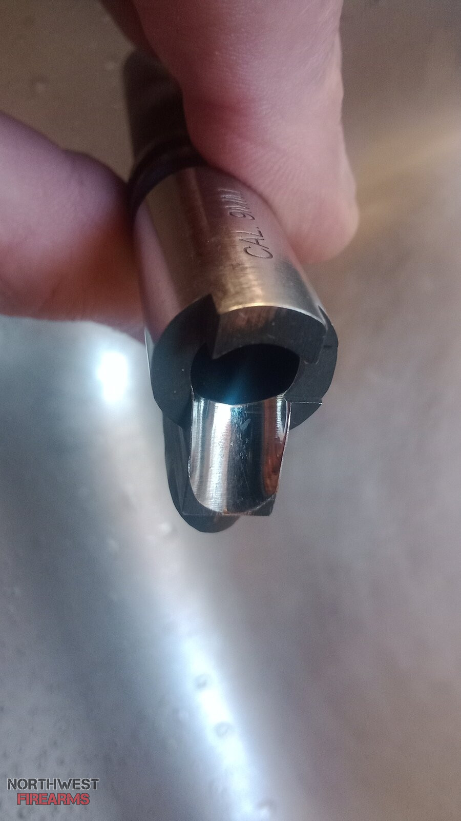

AND the barrel on my RIA IS ramped which may be part of the issue.
This is my first 1911 with a ramped barrel.
Well Im kinda going out on a limb here, im not a gunsmith so someone can correct me if im wrong.
But the angle of the feedramp is the same for the 1911 to work. The bullet still deflects off the ramp to get up and into the chamber.
The ramp was a solution looking for a problem, because many people believe the 1911 slides up the ramp either style so ramping the barrel removed the step in the original design. I own both, and if the bullet isnt crimped enough it will setback with either type of ramp.
The issue is all about a good proper crimp, (or sometimes the wrong feedlip angle on the magazine. )
I'd make sure the top of the chamber opening is smooth
The ramp is very smooth but there is a pretty sharp 'transition' where the ramp stops and chamber 'mouth' begins.
It wouldn't hurt to polish the feed ramp with a Dremel and some metal polish .
I might slightly polish this edge - but it certainly won't be with a Dremel...

Here is my RIA 9mm barrel.
It's actually not too bad for being stock. A closer (and clean) look revealed a smoother ramp - to - mouth transition than I originally thought.
I'll probably forgo any polishing for now and just shoot it!
