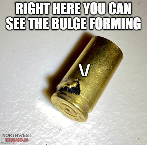

#1 any crimp was removed and primer pocket has be chamfered
#2 you can see slight bulge of OOB or un supported when round went off 3yac9g.jpg
I had that exact thing happen - your case looks almost identical to the one I saved. Happened because of an out of battery detonation - the gun was just slightly out of battery which caused the case to be unsupported enough for it to go BOOM. It felt like my hand got kicked by a donkey, but the gun came out fine.
#2 you can see slight bulge of OOB or un supported when round went off View attachment 689845
Agree with you on the bulge and everyone else it was unsupported. Shot in a G19.

No doubt in my mind the case has been reloaded and the primer crimp has been removed by a case deburring tool leaving a huge bevel on the pocket.

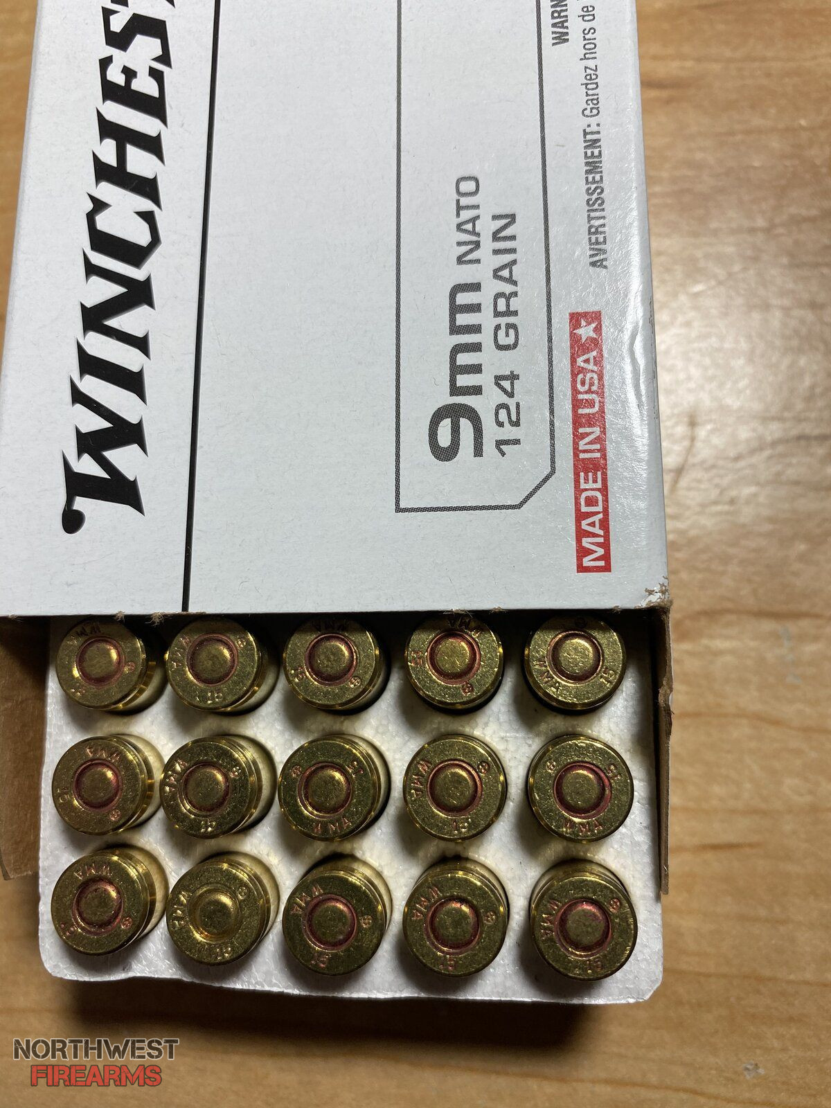

What's the difference? I have shot huge amounts of Winchester NATO 124gr that has the NATO cross and are dated 2015. The cases are marked WMA. Is WCC Winchester White Box non NATO? I have not shot any WCC 9mm rounds.
WCC head stamped 9mm Luger is Winchester commercial production with no crimp. WCC with the NATO "circled cross" 9mm Luger cases are produced for the government with the crimp.
But … mil spec rejects and overrun cases show up in Winchester White boxes with both crimped and uncrimped cases

Can't find the pic in my Imgur album, I'll see if I can find the casing - I kept it and tucked it away someplace. Its pretty much identical to what was already posted by the OP tho. The gun in question when it happened to me was a S&W SD9VE - latest gen Sigma essentially, their clone of a Glock 19. I dry-tested the gun (which was not damaged by the OOB detonation) and found that it would fire something like 1/16th to 1/8th of an inch out of battery :confused: I then checked a Glock (gen 3) and found it to be pretty much the same - my M&P will not drop the striker that far out of battery.
