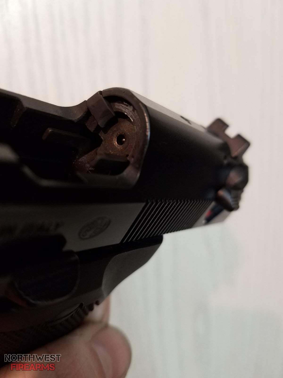

The gun a beretta 92fs went through the case failure with no apparent damage I pulled the gun apart and no cracks, extractor intact, no barrel bulge and it even kicked the case out and fed a fresh round like nothing happened.

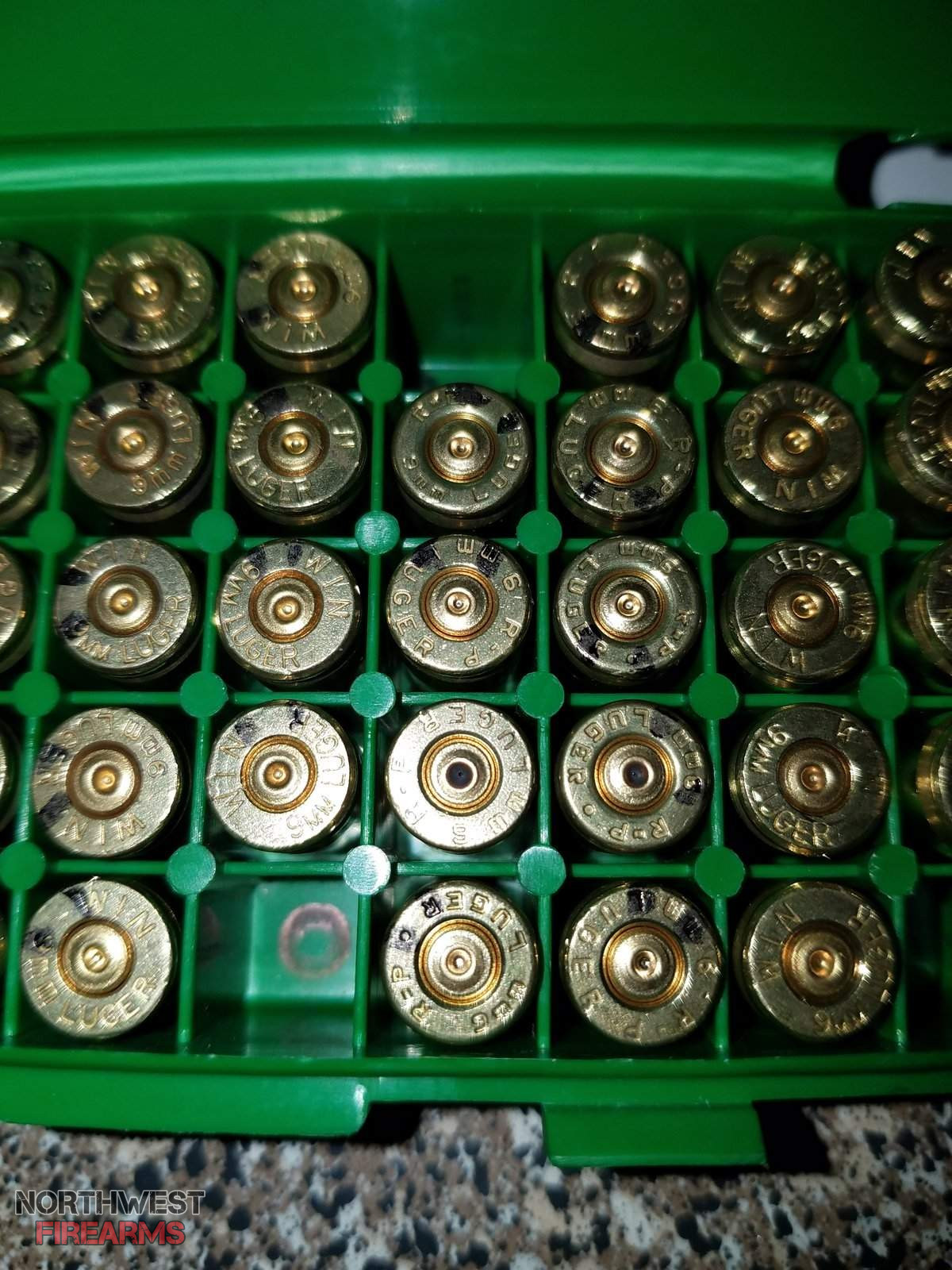

I was surprised because looking at all the primers there is slight cratering but nothing substantial compared to the nuclear loads some people run in their guns.

I have seen loads like that and trying a new method of soft target rounds made sense and I thought to myself nothing can go wrong with 4.3 grains if others go as high as 5grs with the same weight bullet... I was wrong
Something's odd, if you look close the two Remington cases side by side second row from the bottom the primers have been pierced. I'll have to inspect the firing pin tomorrow morning...
i am seeing what looks like some stretching in the webbing in the first pic just under the rupture...unless its a reflection....usually i start seeing a ring just above the belt on my 300 win mag after about 5 or 6 reloads and then toss'm.
