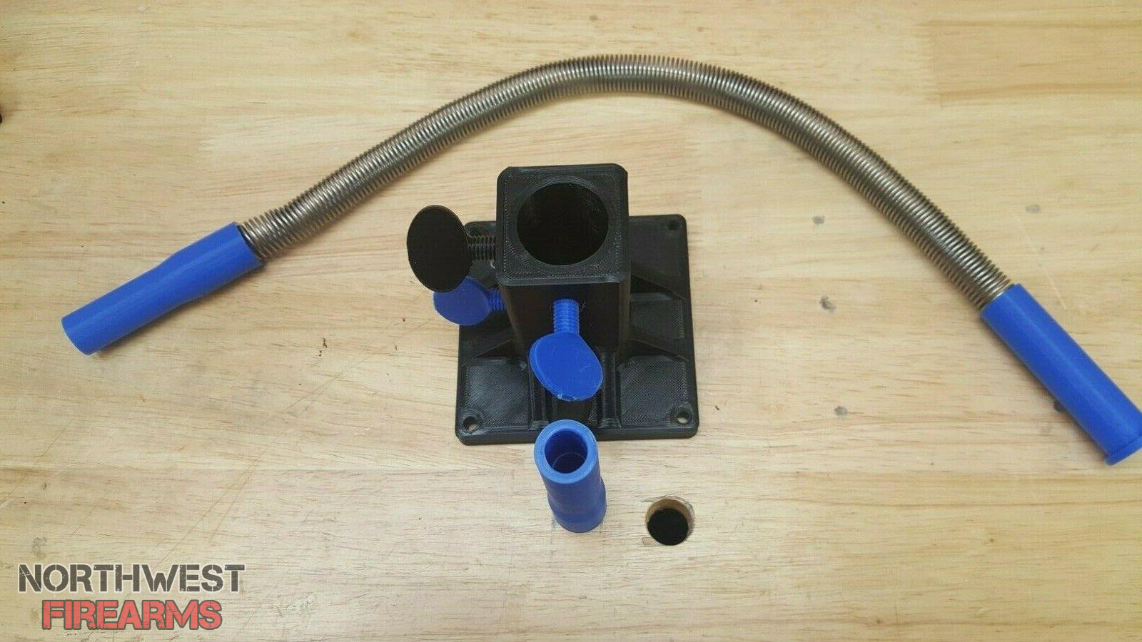

I use a Lee APP for depriming dirty brass, keeps the Dillon clean(er). I bought an adapter that lets me use my case feeder with the APP, it goes pretty fast once you get it setup.

Could you please elaborate on what case feeder and adapter you are using? I've been considering getting mine set up like this as well.
The kit I got off of the bay looks like this. I added a dowel and put my Dillon case feeder on it. If you had a 3D printer you could probably make your own, these are definitely printed. But it works great, and I don't have to the use the Lee case collator thing. If you already have a case feeder, it's pretty cheap upgrade - I think it was $45.
Thank you, I don't have a case feeder yet but looking to put a system together that works with what I currently have without buying multiple times. Looks like a good system for sure!
