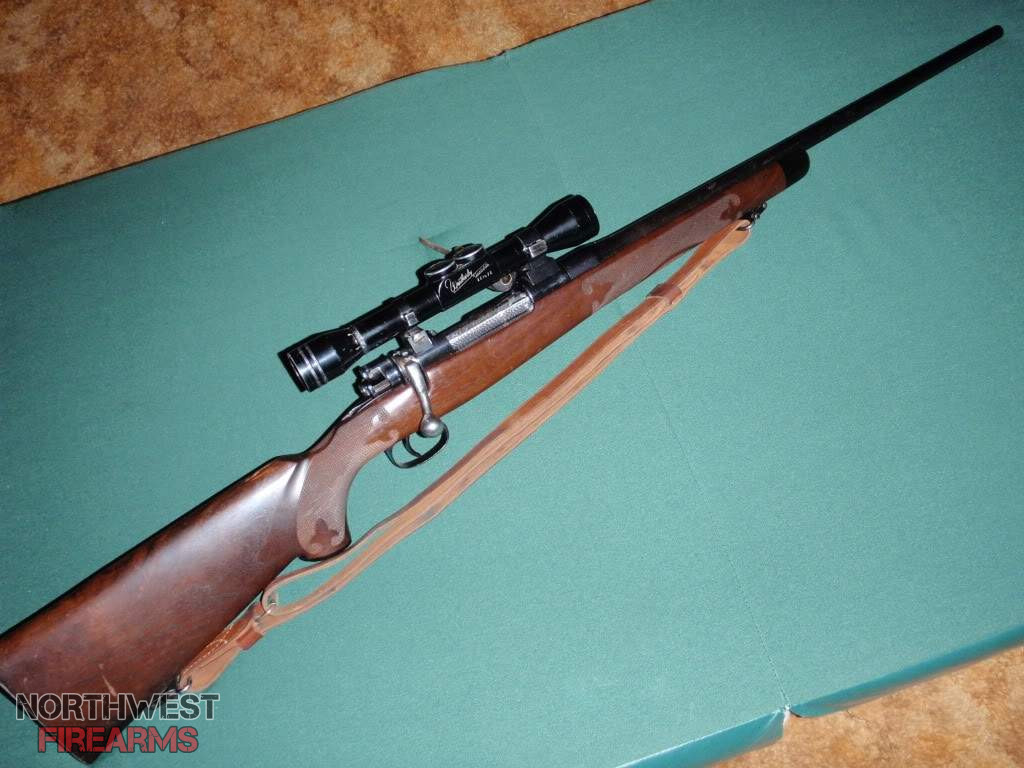

If the Ackley ideas are appealing, go with what ol' P.O. LEARNED: His .276 Ackley Magnum (a 7mm), was shorter than any mentioned here (including the Remington), and was at the absolute wall he discovered for efficiency and performance. Anything beyond was throwing bad after good.
A fine Mauser built by P.O. himself, chambered in the "sensibly efficient" .276 Ackley Magnum:
Now you dunn it! Gave me even more to think about. Beautiful weapon,I'm interested in more info on both rifle & ctg. specs. I looked in most of my manuals,don't see any info on .276 Ackley. Guess I'm going to the book store. Thanks in advance for the suggestion & the info.
