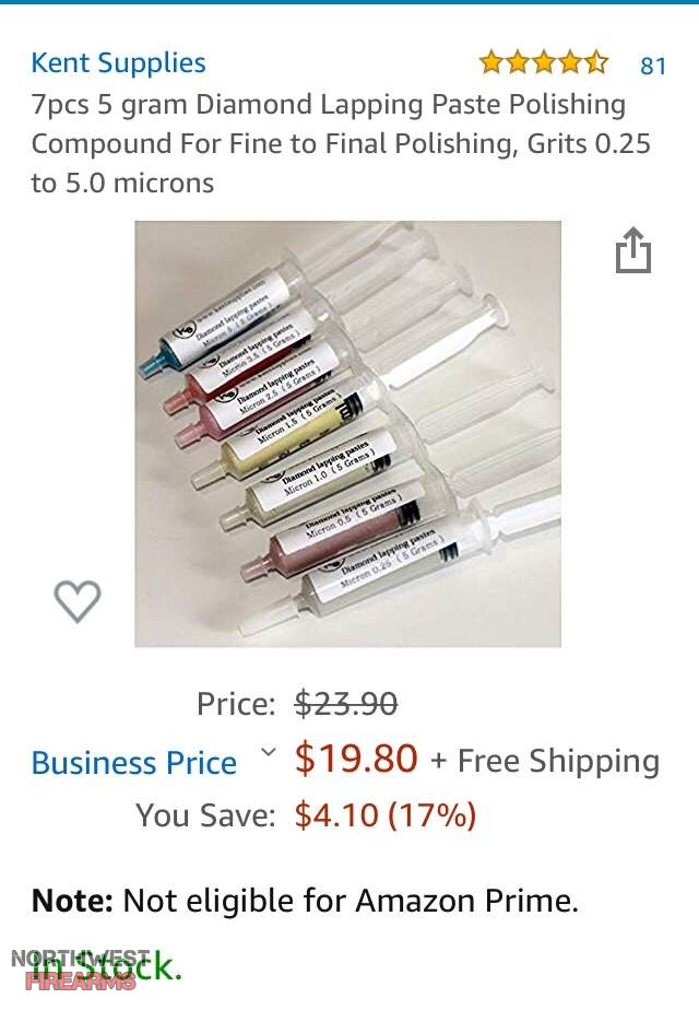

If it were me, I'd find some fine diamond lapping compound and clean up the chamber. You could use a larger size barrel mop attached to a drill motor and polish it up.
Maybe something like this

Interesting. I'll be picking up some brass-cased ammo today but I'll also give the lapping compounds a look too. Thanks for the recommendation.

I'd give the chamber a darn good cleaning with a bore brush chocked up in a drill. That should get it good and clean. Then run the brass stuff. Then if it's still a tight chamber, start lapping compounds.
I never recommend any sort of permanent modifications until all other trouble shooting has been performed.

This is why I thought the lapping/polishing may be a decent idea. Take a few millionths of an inch off the chamber to open it up a RCH and smooth things out to reduce excess friction. Also why I thought brass cased ammo would be better as brass already has better lubricity than steel.
