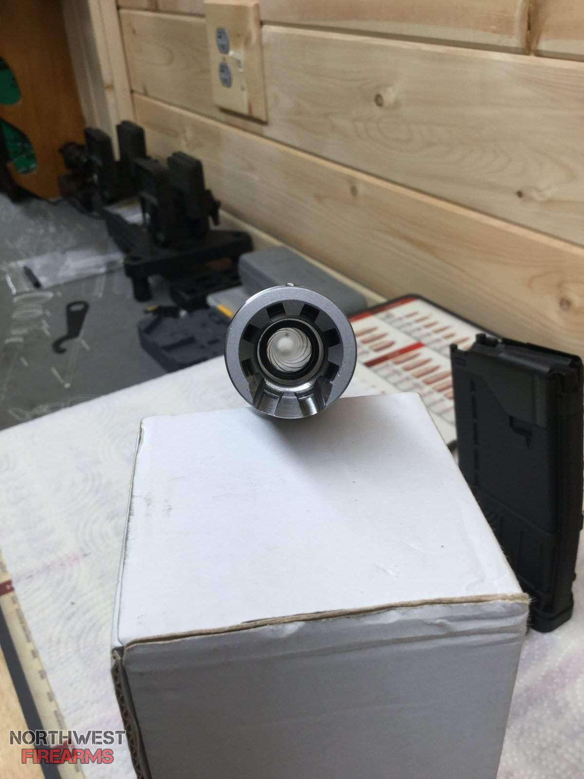

I have always reloaded and shot 45-70 but also have been intrigued by this AR chambering, so I finally did it. I have parts coming for a 458 Socom upper build. It will consist of an Anderson stripped 458 upper coupled to a stainless Tromix 16.25" barrel with a matched bolt. The rest of the parts will come from my current stockpile as I see fit. I did however order a couple of Tromix modded mags with center feed followers to feed the beast. My intent is for a hunting/critter protection weapon. With the high quality Tromix parts it looks like I will be in it for about $550 or so when done. Anybody else build one of these lately? As always comments and advise is welcome!

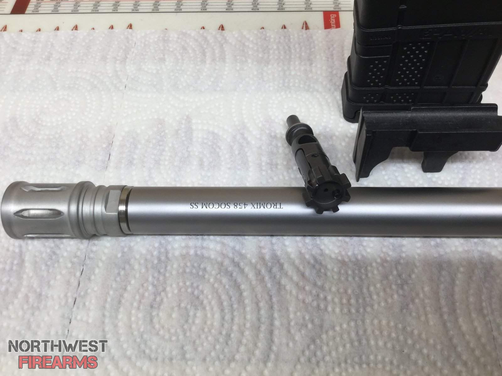

722F01B1-307B-4101-9DB8-91367CE1ABBE.jpeg 59066902-30A5-46BE-A1A1-544E1663ED19.jpeg 126C62D5-8B6C-4369-A05E-CE55E92FF7BA.jpeg

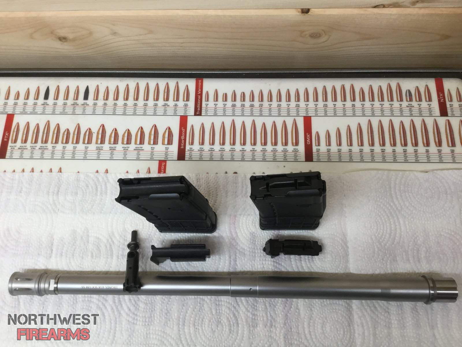

Yes, I will reload, brass and dies already enroute. I will start with bullets I have already for my 45-70. I may buy some controlled fracture projectiles when I get serious about hunting with it. Here are some pics. Note the single groove follower Tony machines for use in the Lancer Mags compared with the stock version. Machine work is top notch on everything.

Those Tromix parts look very high quality.

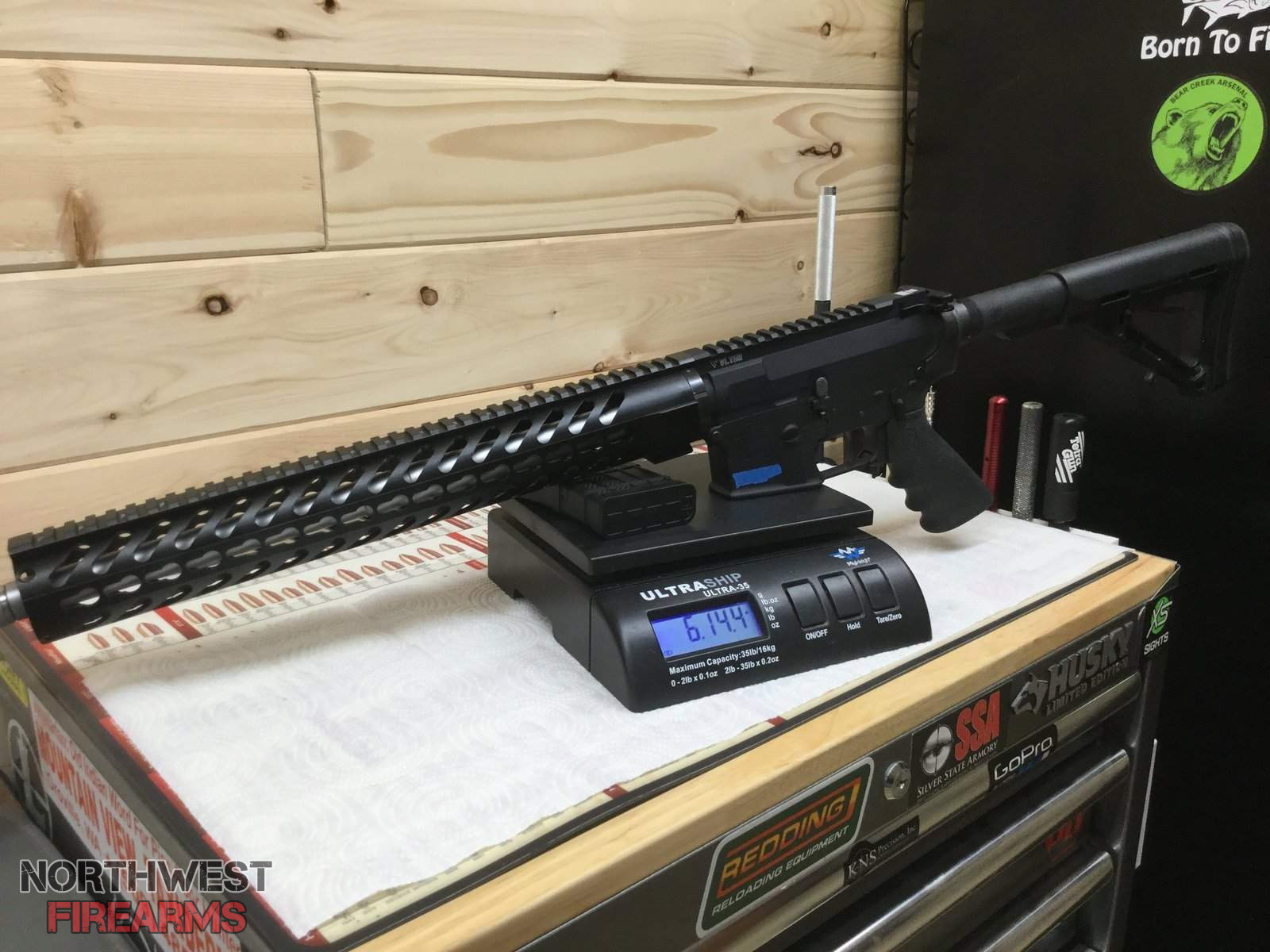

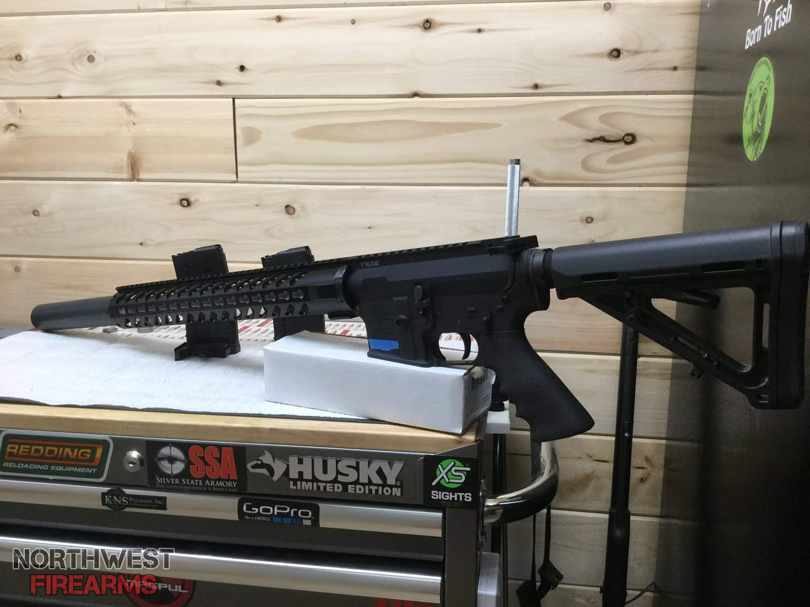

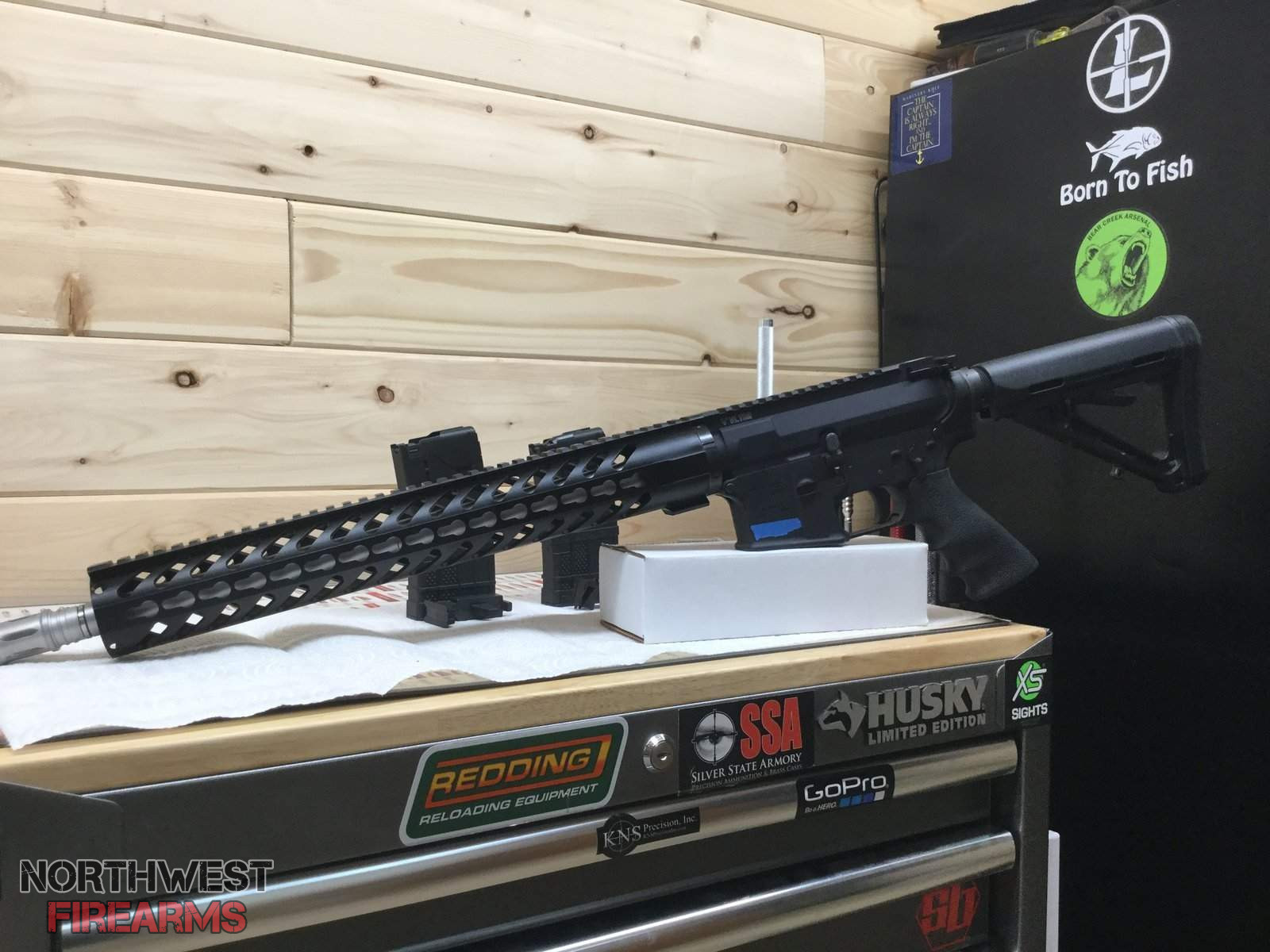

I had not heard of the 45-70 auto, it looks interesting albeit costly. I load my 45-70 only to midrange to slightly hotter and I believe the 458 socom will closely match it ballistically. With today's projectile choices, max velocity is not always required. It will be fun to wring this one out! Here is a mock up of what finished rifle will look like. I used a viltor stripped upper I had laying around just for a look, as the Anderson 458 upper and gas block are still in transit. Second pic with hybrid can attached.

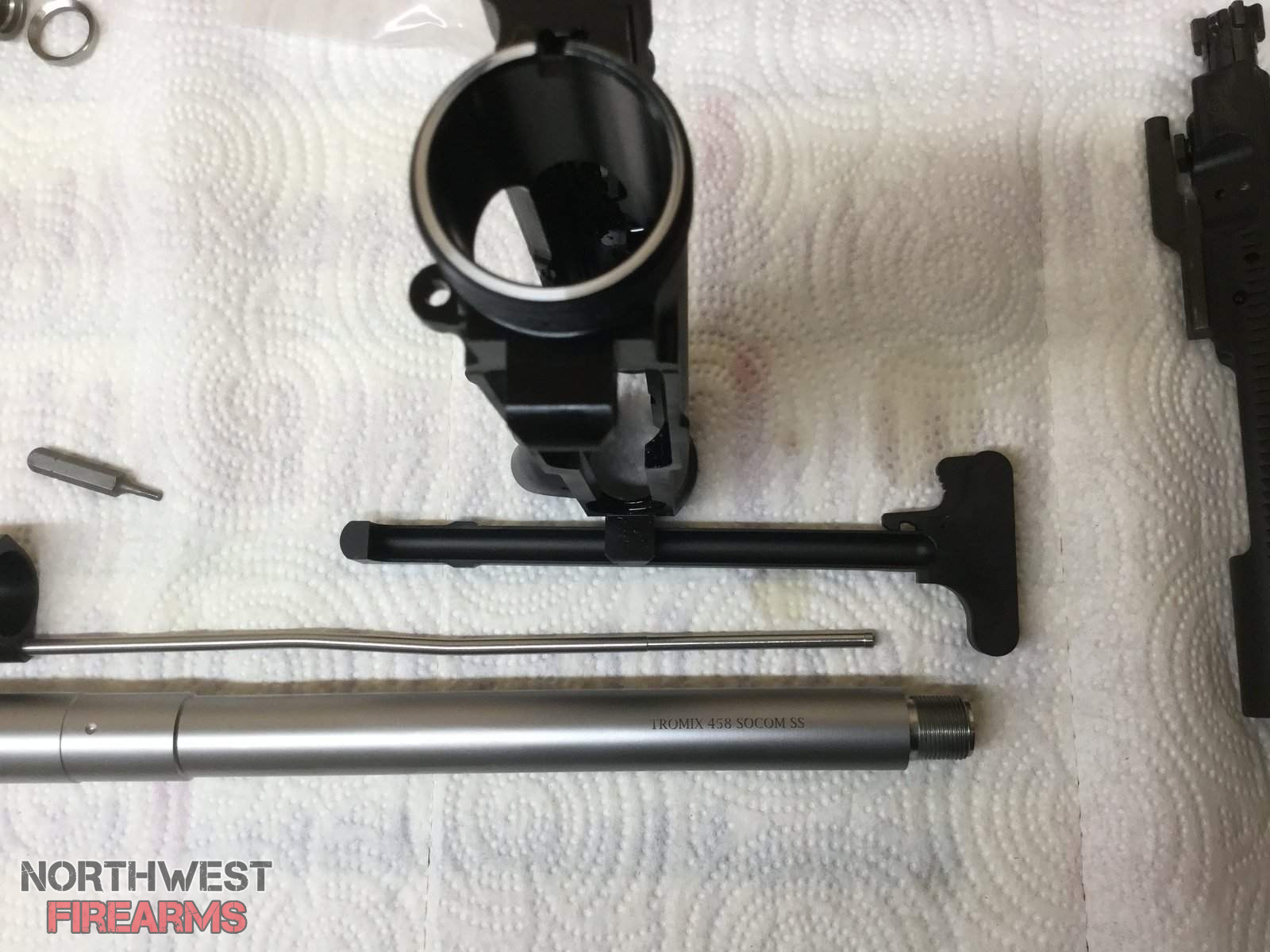

The rest of my parts showed up today so I went ahead and built the upper out. All went well with just a couple notes. The finish on the Anderson 458 stripped upper seemed harder and deeper Black than previous Anderson's and it took much longer to lap the front face of the receiver than usual. This is a good thing as I was never too impressed with their finish before. Also a tip to new builders, always have spares of small parts that seem to fly into oblivion never to be seen again. Having spares will save you the grief of waiting for a replacement before being able to finish your build. I managed to launch a gas tube pin into never never land but was saved by a spare. Barrel nut ended up torqued at about 32 ft/lbs with no shims required. I topped it with a strike eagle for its first range session. I can't wait to build some loads this week and maybe shoot it next weekend. I am hoping for a moa thumper:).

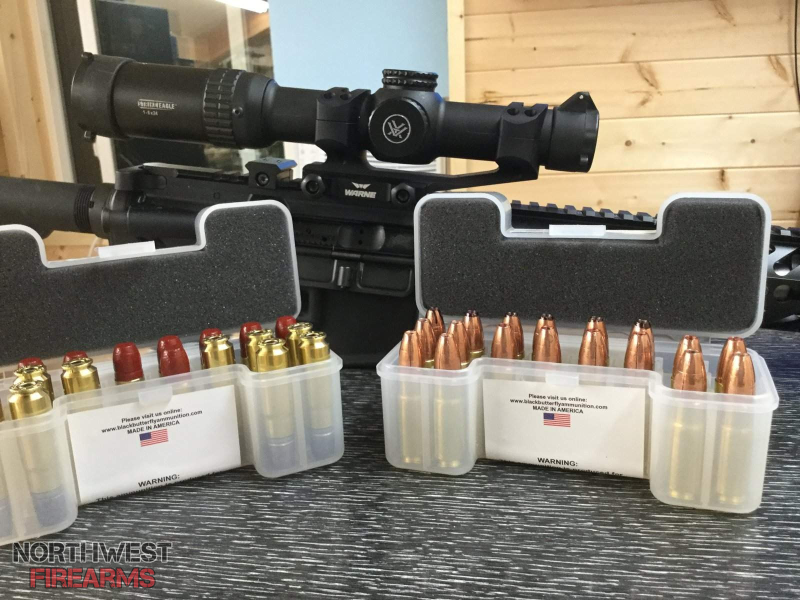

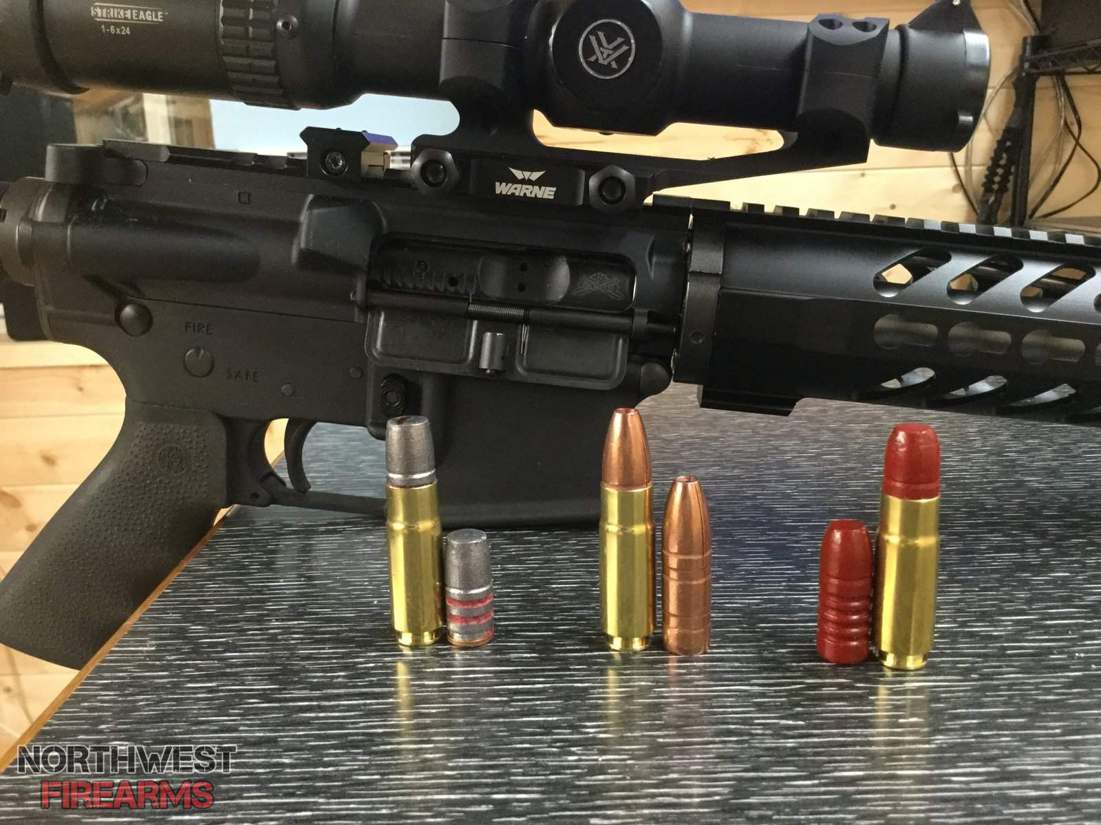

I am hoping to get out and move my load developing forward this weekend. I have 3 different bullets to test at various load levels and different powders both super and sub. Center in first pic is 500gr Maker Rex subsonic expanding projectile and yes she is stuffed way the hell in the case. I have my magneto speed configured properly now so some chrono data should be obtained as well.

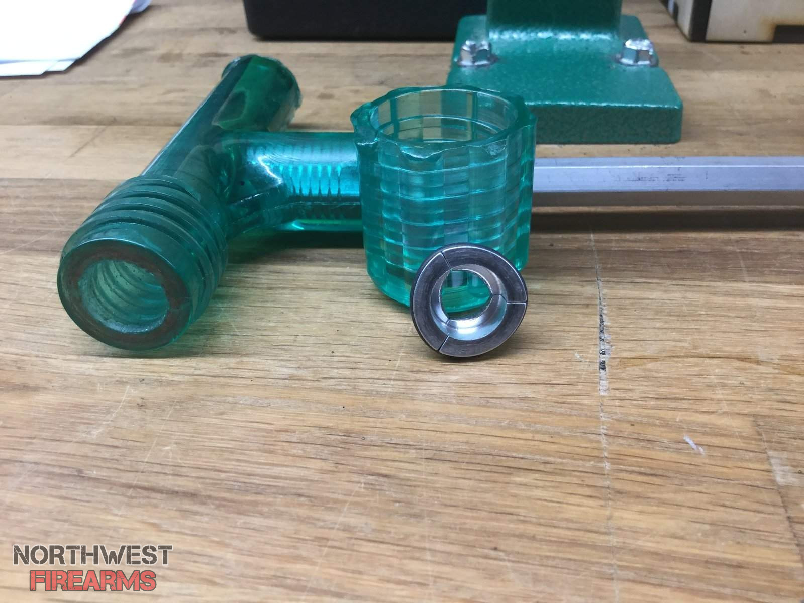

A case gauge would be too easy lol. Now that I have modded the jaws of one of my kinetic bullet pullers to work with the socom case I have been making dummy rounds with each bullet type to check for function in chamber. My sizing seems ok but I have had to adjust seating depths on some bullets based off the dummy rounds.Here is a pic of jaw mod on puller done on my metal lathe.
