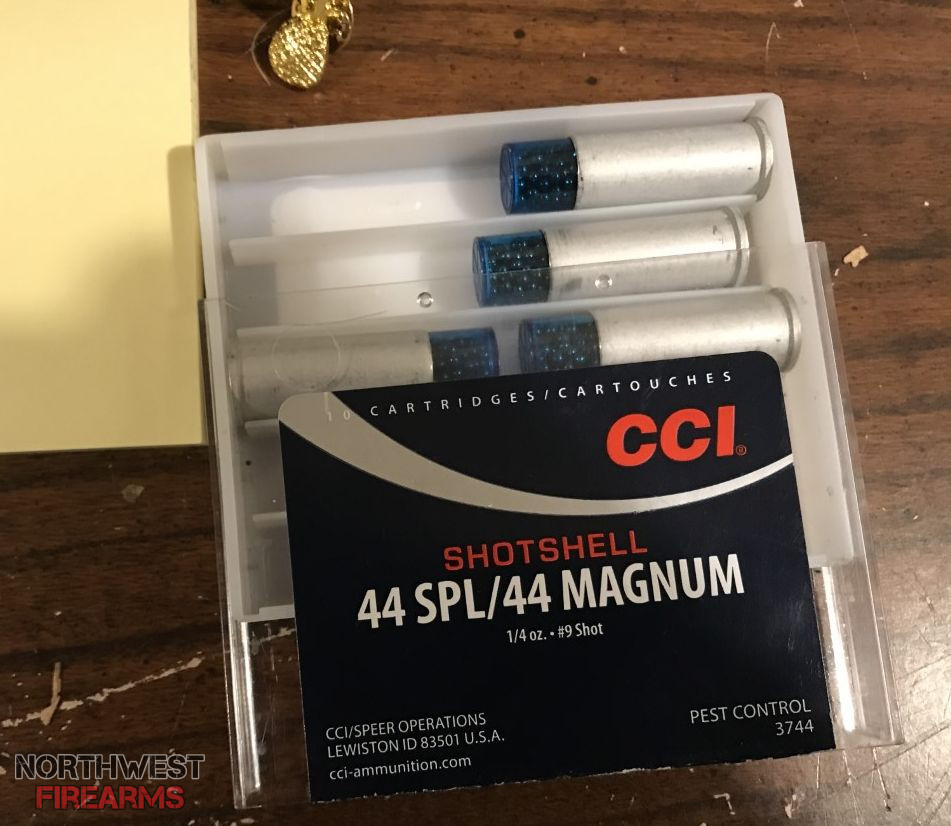

So there are 44 magnum loads that are not considered "manstoppers"... ?
Well, these are "ratstoppers".
(Parenthetically, the last varmint I dispatched here was a large rat with a .357 loaded with the same. And by "large rat" I mean I suspected it was actually a chihuahua who had donned a rat costume. :s0112:)
