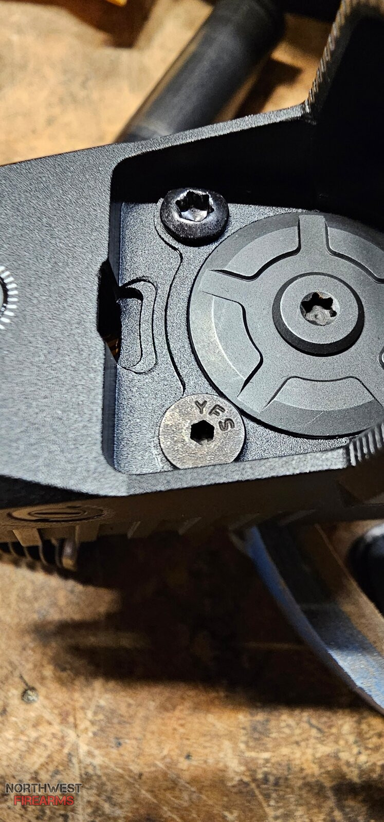

The longer 4-40 screws thread much deeper. Im also using loctite. I think there is more than enough thread engagement... the question would be screw material shear strength, im not certain what I got though?
There is a marking on top... "YFS".
YFS is a good product.
No idea what grade those would be....you might be able to search it.

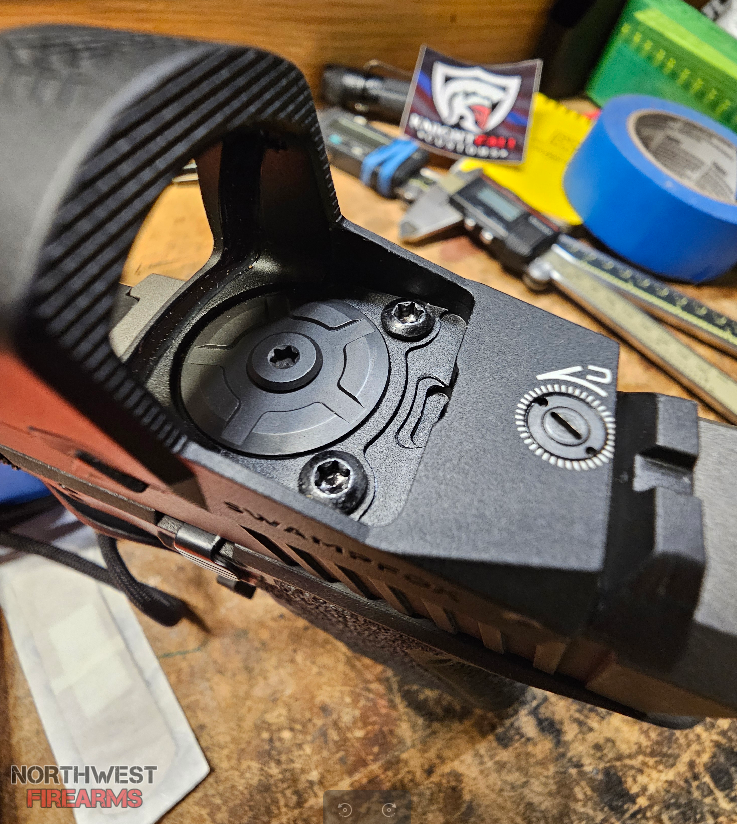

I did find a screw that works, if less than ideal but it beveled and the correct 3/8" length... does not interfere with extractor, it is odd Swampfox didnt test this for such a common gun (G19)

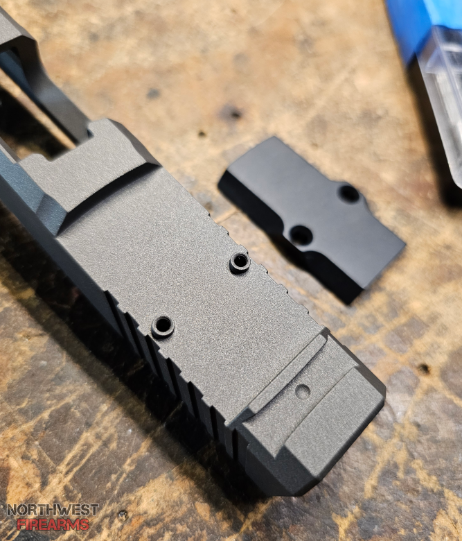

Also I think the real issue is the slide cut, is the RMR cut without the locating pins and put a "boss" feature where the threaded holes are, which is why 4-40 instead of the usual 6-32. Swampfox included 4 sets of mounting screws in various lengths, but only one of those was 4-40.
I personally am not fond of this modified RMR cut. I have another gun with the dedicated boss pins up front and that optic fit very precise. This modified cut has a lot of slop and very much needs the bevel to align.... i dont like that with smaller weaker screws. But I guess it works enough that slides are made that way.

The choice now is that the csk screws I bought are the perfect length and holding fine. I have a hex driver bit I ordered on the way so I can properly torque them. This optic went on a backup/spare gun so no hurry on this project, though I am anxious to zero the Swampfox.
Well I finally go around to putting the correct screws in. I contacted Swampfox and they were no help just directed me to their screw kit to buy that was out of stock. The Aimsurplus link in this thread still had them though so I ordered the kit, $16.99 plus shipping just to have the correct 2 oval head Swampfox screws with the#10 torx driver... they come extra long requiring me to modify and grind down to the correct length. The kit contained screws for all of their optics for whatever thats worth.
I clamped the tiny screws in a work vise with leather to protect the screw heads and used an angle air grinder with a sanding disk. I went slow, carefully chamfered the thread tips, tested the length in the slide, repeat process until the screw does not protrude into the extractor hole. I don't have a good way to correctly measure the true length of oval head screws, so the overall length that worked for me was about .410". By "eye" using the caliper tips, the true/correct length came out at 3/8"... so the correct screw to have ordered should be a 4-40x3/8" long oval head #10 torx screw, if I could ever find any. The csk version also works perfect.
For reference now that I'm here typing, here is a pic of what I call the "modified RMR" cut, without the two recoil bosses up front to align the optic. The original RMR cut does not have threaded bosses and uses 6-32 threads in those locations.
For all the effort I do think the oval head screws look better than the csk screws. Now I need to find the time to zero the optic.

@Koda I may have missed this - is that an original "modification" done on the slide, or is that from the factory? Sorry to hear Swampfox's customer service wasn't all that. I've heard very good things about their optics for the price and their customer service, though haven't bought anything from them myself.
Not a mod, from the factory. Its an aftermarket slide. A web search shows this is not uncommon version of the RMR footprint.
