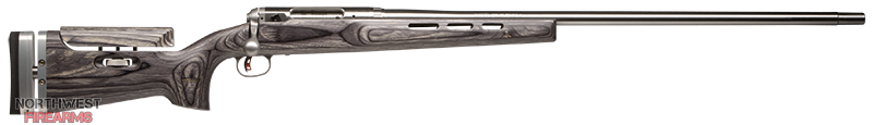

Look at the .308 Palma loads, they use small rifle primers on the 155 g AMAX, and in the team Savage youtube video from shot show they claim a 4" group at 1000 yds??? Out of the 30" barrel. I picked this up a couple of months ago, so I did a little research, but my range here is limited to 400 yards, so it's never been out of the box. I did look for the small rifle primer brass, but didn't have much luck. I did find that Lapua makes it.

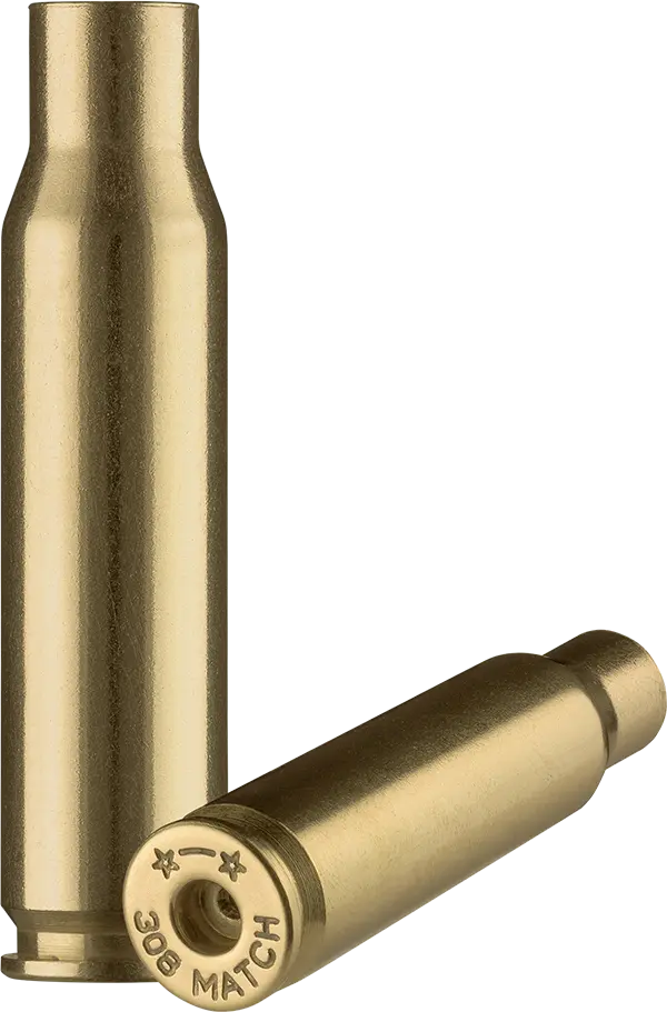

Starline makes 308match brass as well which use srp.
I already got 308Win Lapua brass with small primer pockets. I purchased it last year and so far never used it. I still have over 1,000 Fed M210G LR match primers. After I spend them, I guess I will move to small rifle primers. MidwayUSA had yesterday Fed G205M small rifle match primers and I was able to buy two bricks (2,000 primers).

Starline does not indicate impact on accuracy. In fact they call starline 308 small primer pocket brass "match" grade. They do however state care needs to be taken:
"*As with all types of cases this large with small primer pockets, it will require care in powder and primer selection in cooler temperatures to prevent hang fires. Single-based propellents are generally easier to ignite and a quality primer such as the Remington 7 1/2 BR are recommended."
