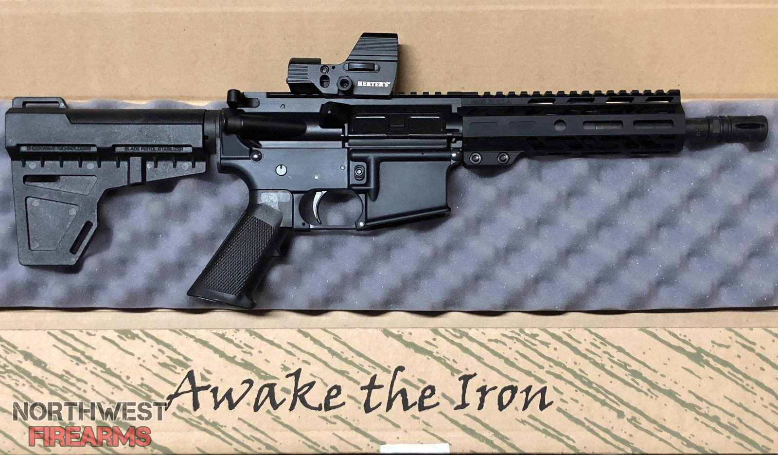

Heck, got it build, now I need to build rounds that it likes...
