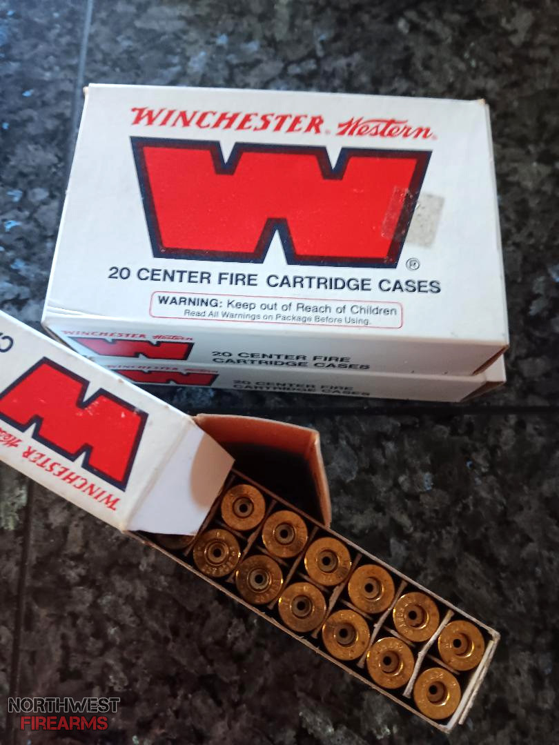

Hope you have good luck with your search. I ended up with the other problem. A friend gave me a pile of 257 Roberts brass and loaded ammo so I ended up having to find a gun lol.
