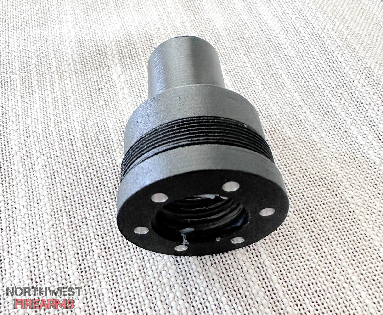

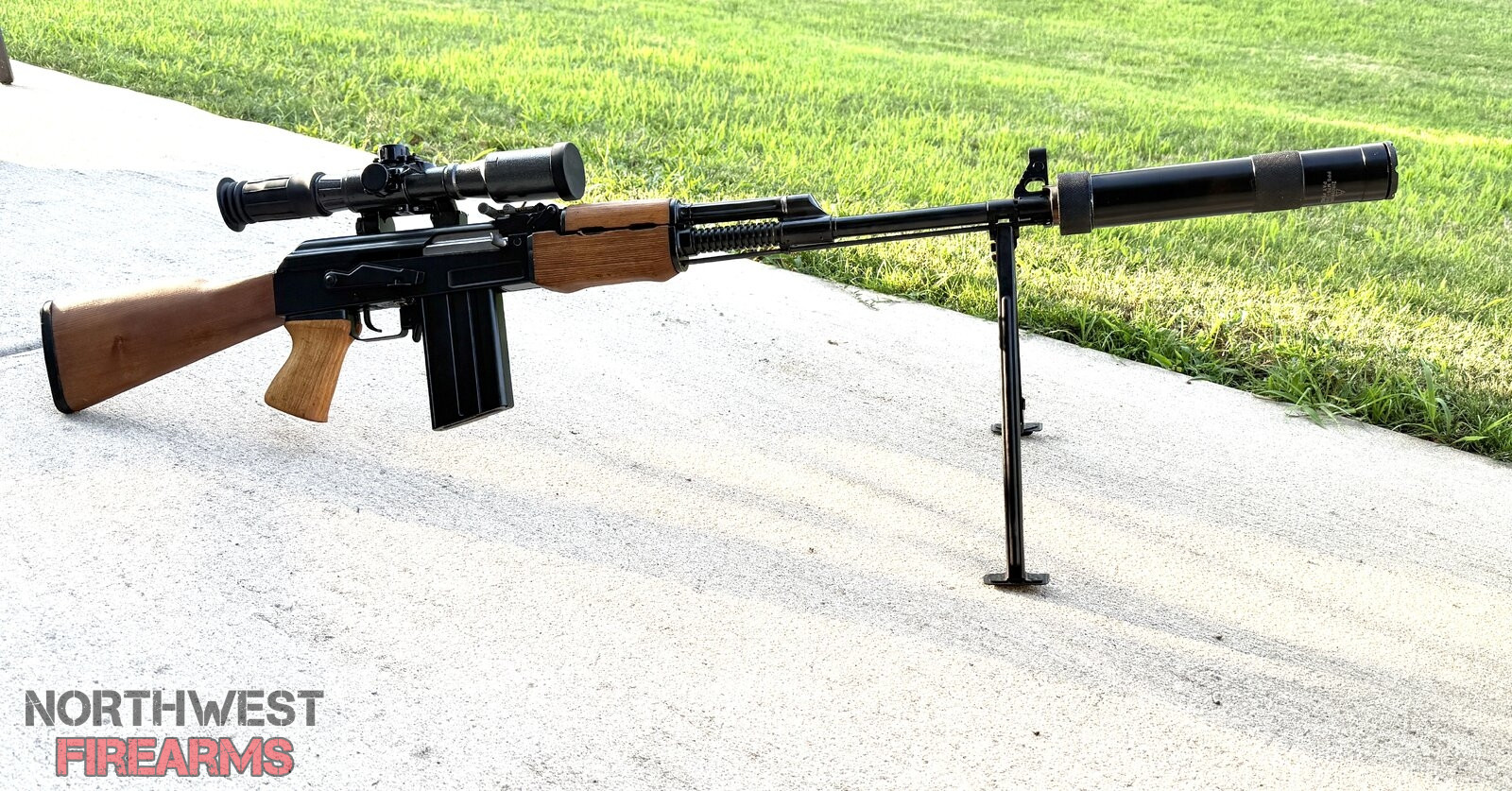

Made a 2 piece mount for my 30.06 M76 this morning. Threads on the M76 are 22x3 mm LH metric trapezoidal and theyre tapered too on top of being interupted. Not really acme as theyre almost crested like standard metric 55 degree. Too much going on there for my old standard only Hendey lathe . Bought a tap, cut the taper to the base and made a mid mount sleeve to all fit into a GSL multical . Solid as a rock and bore concentric.
The aluminum isn't a problem with heat?? Interesting.
No. Its just the back cap and its fully isolated from hot gasses . The stainless sleeve extends to the threads. Its a two part construction because of the way the flash hider and threads come together and its all threaded and rocksetted together

I make an adapter for the LH 22x3 metric trapezoidal TAPERED threads. I do not grind down the flash hider threads. They are extremely short threads and need a extension built into the adapter to index off the flash hider so the suppressor doesn't droop. It has to be a two piece design. The weapon is not modified.
