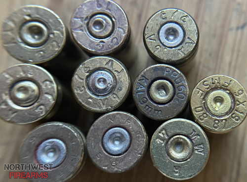

9mm Roll forming at 5-6k per hr and case prep press running at 2500 CPH and "wham'O"press stops with the read out "Case obstruction or Yellow Sensor". Well yellow sensor means the de-primer sensor has been tripped, or pressed upward. Sure enough the decapping pin is bent from hitting something solid in the case. Check the current case, no obstructions but the primer is still there. Ok last case. Check that one and find this little gem.
WTH!!!! 9mm Berdan primer from 1975. Great. I bought a bunch of range pick ups from a old timer that used to be a range officer at Tri County and said he has been picking up brass for years, then sticking it in his storage unit. Well he cleaned out his storage unit and sold me a metric crap ton of brass. (I may have gone overboard, talking buckets measured by a bathroom scale) He had bags of military, ok fine with that all sorted and I can auto swage the primer pockets. But a freeken 9mm Berdan case from 1975!! Sheesh. Did not see that coming. Been….well never seen in person a Berdan 9mm. Plenty of .308 and a few 5.56. So far two have showed up. Looking into the 2nd one, you can see the small middle dent where the decapping pin hit then pushed up and trigged the press to auto stop. No so lucky on the fist one I had the pin set much tighter. Great now I have to run the rest of these with the pin set light (thus any tight primers will also trigger it to stop)

Maybe not that exact headstamp, but Berdan was formerly about the only primer in many European and some Asian manufacturers' ammo. The case may be slightly more expensive to produce, but the primers are far simpler (cheaper) to make. Oddly, the Berdan primer was an American development while the Boxer primer was from Europe (UK).
But how to sort? Sometimes, the cost of cheap brass comes back to bite.
Wow, been reloading since the mid 1980's, lots of mixed range brass over the years, never seen a Berden primed 9mm…. Always worth a quick inspection before beginning processing.

What po18guy said. With over 40 years of reloading 9mm and being a brass scrounge I've defiantly seen my share of berdan 9mm. Very surprised this came as a surprise.
As for how to start, 100% why I process brass of line from reloading. (Also to catch the devils caliber .380 that sneaks into 9mm and the occasional .38 Supper, see that stuff all the time) With the de capping pin set light the cost is just a little more time as the press cycles though the batch. I have flagged that "bucket" and will just keep an eye on it. The press is fully automated so it will pause when it hits another so I can sort it and put it in my "WTH" hall of fame bucket of weird stuff that shows up like .45 GAP. (Buckets of .45 ACP always yields a few doz. GAP) I see enough 9mm Berdan it will go in the scrap bucket.

I've been popping off some corrosive berdan primed Egyptian 9mm lately just to get rid if it. Probably 30% no fire first strike. I just leave em lie. Cruddy little things.
There's another advantage to doing single stage, I guess. After a few K of 9mm you get to know what different brasses feel like. I'd certainly know to stop pulling the handle at Berdan.

As others have mentioned when decapping 9mm, I can feel the difference in the pull of the handle on my Redding turret press if a .380 acp case (pull is easier) or a Berdan primer got mixed in.

We just got done sorting a bunch of 9mm brass, found a few berdan pieces mixed in: several Egyptian, a couple Finnish, one from Argentina, one from Yugoslavia , and a WWI German.

We're processing this for someone else; no idea where it originally came form. You never know what you'll find. Sometimes it's all pretty good, sometimes it looks like floor sweepings with lots of scrap to sort out.
