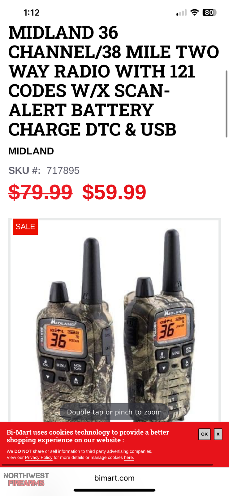

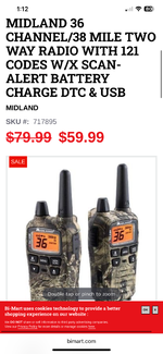

Does anyone have any recommendations on a cheep set of walkie talkies? Camo would be cool. Something just for in the car/road trip/no phone service comms. The wife and I are wanting something for a trip coming up soon. Amazon has a ton of options of course, the majority of which looks like crap. Wondering if anyone has any experience with a decent option that is smaller (pocket size,) and is gonna hold a charge and won't fall apart after a few uses. Camo would be cool or just not neon colors.

says if you click lucky tuesday in there shows for 39.99 tuesday only

Those are different radios. The ones in the new ad are 38-mile. The Tuesday only ones are 32-mile. Neither sounds like too bad of a deal.
I don't have any experience with Midland, but the Motorola radios I've had didn't wear all that well. For the price, I suppose they were okay.
@Jbsheepdog
oh my bad on overlooking that. i know back in day midland were good radios
32-38 same difference to me at that range
