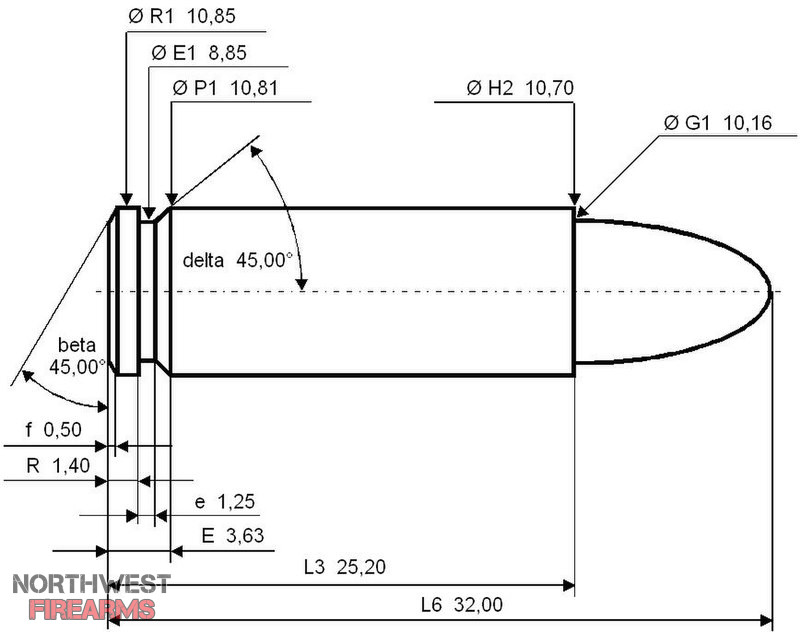

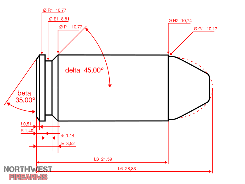

It just occurred to me that this might be possible.
However the case dimensions are slightly different
10mm Auto:
.40 S&W
Which surprised me a bit. Will an appropriately shortened 10mm Auto case fit into a .40 S&W chamber?
I am given to understand that the 10mm case has a stronger web, and shortened it would have less case capacity than a .40 S&W case.
